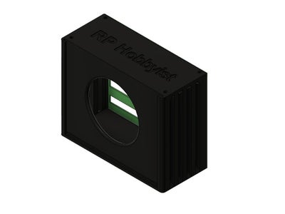

Step 1: Print All 3D STL File
Support print need while printing.
Note: I have updated the Latest Design, so minor changes you will see in 3D printed parts.

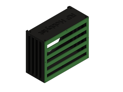

Step 2: Cut the Mask As Shown in the Figure and Attach It to the Frame of the Filter
Use 1 layer of 3ply Mask. Use super glue to stick filter on the frame. It is washable so no problem of changing every time.

Step 5: Put the Filter Plate in This Slot Given in Front of the Body

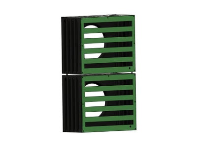

Step 7: You Can Make Two of Them and Stack on Each Other
Use spacer for Stacking.

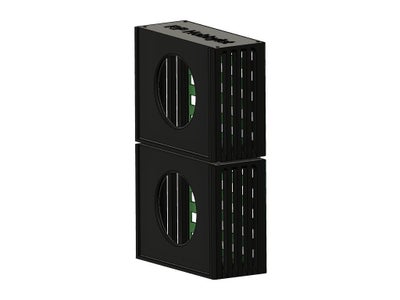

Step 8: Ready to Use It !!!
Step 9: RESULT!!!
