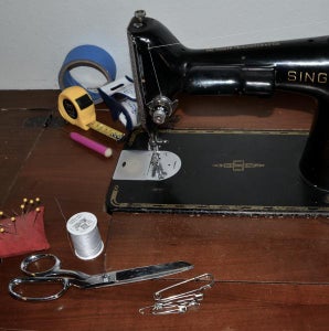

Tools:
  • Needles and (optional sewing machine)
  • Scissors or sharp knife
  • Serrated bread knife
  • Flat wood cooking stirrer or stick
Air duvet supplies:
  • Packing or duct tape (Optional: Painter's tape)
  • Light rope, webbing or fabric to sew straps

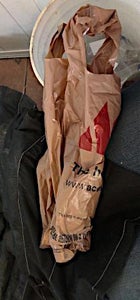

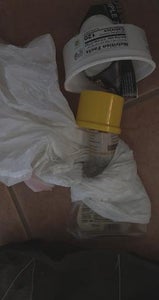

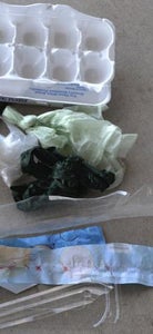

  • Hard fill- clean small plastic bottles, soft plastic containers and lids, plastic foam egg cartons and packing
  • Soft fill- fabric scraps, medium weight plastic film or bags, down or synthetic pillow fill or life jacket fill

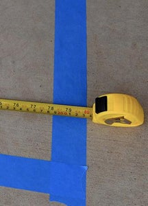

Step 1: Measure Air Duvet Layers

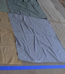

Work is easiest if you have a clean floor area or several tables to join together.

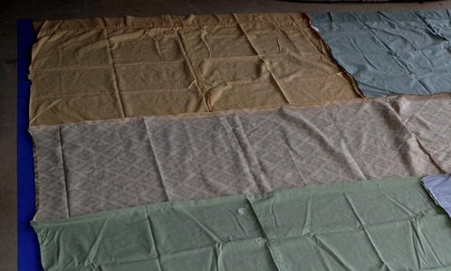

Mark the duvet cover size with painter's tape or chalk.
Lay out materials for each layer on the size marks to see if you have enough material before sewing.

Step 3: Cut and Size Each Layer
5 or 6 pillow cases should make a layer, or 6- 8 grain bags. Make sure the plastic film is clean from food residue or grease.

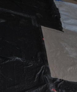

If you have a lot of film, leave bags intact. Lay them side by side and tape them together.
If you have less film, cut the bags and spread them open before taping.
Step 4: Make Layers
Connect pieces of fabric or film into flat panels the right size.
If tape connecting plastic film pieces is loose in spots, sew these pieces together, or tack them at corners with thread.

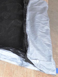

Work with one side of the air duvet pocket at a time.

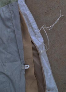

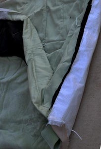

First spread the lining fabric out smooth within the size marks. Any seams should be aiming up toward you.

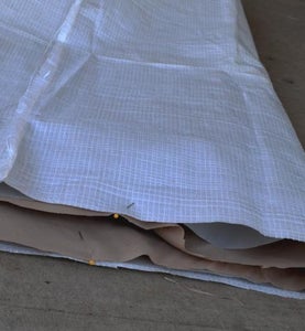

Above that lay the film layer. On top lay the bottom wearing surface next. If it has seams they should be hidden from you, with the nice surface showing.

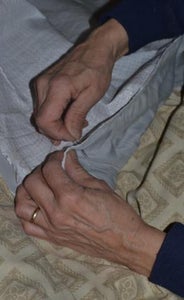

Pin the edges of all three layers of the fabric and film together.
The fabric will need to extend further on one side for a neat hem. Turn the fabric back 5 cm (2") on this side and trim the lining and plastic film layers back.
Step 6: Sew One Side of the Pocket
Sew the three layers together on all sides.
Hem the longer side by folding the wearing fabric over the film and lining. Sew the hem.

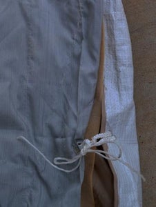

Step 7: Add Loops
Cut rope, webbing or strap into two 9 cm (3.5") lengths. These loops will hold string to tie the quilt sides together and hold a blanket inside during the night. They can also hold straps to tie the quilt into a roll.
Fold the rope or strap pieces in half and pin these loops on the wearing surface facing the hem. Space them at 1/3 and 2/3 the length of the quilt.
Sew multiple rows of stitching over each loop to hold it securely.
Run string or cord through each loop.

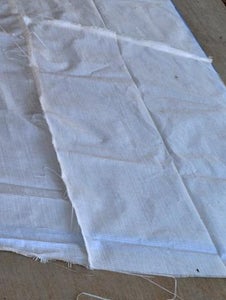

A layer of woven polyethylene (PE) grain or sand bags will fray easily. Sew an extra line of stitching 15 mm (3/4") in from the trimmed edge on layers of this rough woven fabric. For a hem on a PE bag fabric wearing layer either leave the lining fabric longer or cut a strip of another fabric 12 cm (5") wide to trim the exposed edge of the grain bags.

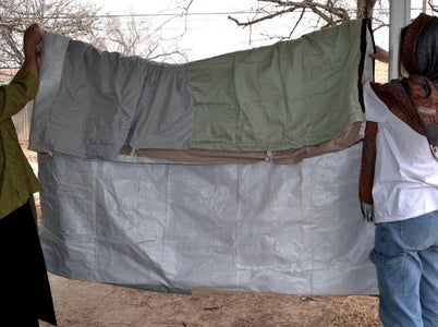

Add three extra hanging loops 12 cm (5") long on the top wearing surface (which should be the strongest fabric). Locate these loops 125 cm (50") from the end opposite the hem. Two loops should be near the sides and one in the middle. These loops can be used to hang the quilt to the south tent wall during the summer, (usually only 125 cm (50") high to the roof) to reduce solar overheating.

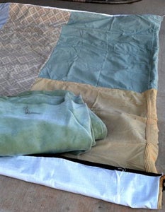

Lay the two wearing sides together, with hems matching and sew the three sides of the air duvet.
Turn this padded pocket right side out.

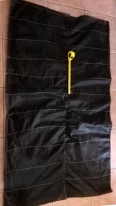

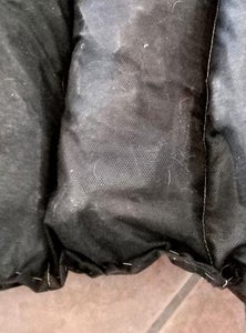

Step 10: Sew Your Mat

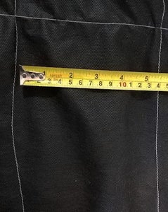

Sew channels running across the mat fabric for short channels that will be easier to stuff.
As you fill the channels, the length perpendicular to the fill logs will get shorter. Match the UN issued mattress size of 90 x 190 (35 x 75").
Sew two sides together every 14- 16 cm (5.5- 6.25"). Stop these seams 1 cm from the edges.

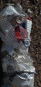

For mesh tubing, stuff the tube lengths first and then sew and tie them together after filling. A large crochet hook or yarn needle makes this step easy. Tie or sew the tubing together on both sides to make the mat stronger.

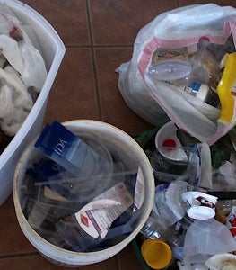

Step 11: Prepare Plastic Fill
Crush clean plastic containers underfoot. Cut larger ones into strips to fit inside the channels using a bread knife.
Plastic bags insulate and also cushion sharp edges best if twisted and bunched into multi-layer wads. Cut fabric into pieces as wide as the channels. Plastic foam works very well and can be trimmed into narrower strips.

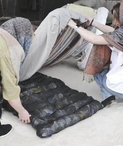

Step 12: Stuff Your Mat
Twist or fold soft plastic pieces and slide them into the channels all the way to the middle. Keep the channels uniformly full. If there are few plastic bottles and containers, cut plastic strips and roll them into a spring and insert.
Stuff plastic into channels about 30 cm (12"), then add soft fill.
Wrap hardest pieces in soft fill to prevent sharp plastic edges cutting the mat fabric. For most scrap plastic, cushion the top surface of the fill with soft fill. Fold twisted bags or fabric over a flat cooking stirrer or a stick and slide it into the channel on top of the hard plastic.
Step on the channel- it should not flatten completely. Empty air spaces are ok as long as the mat overall holds up a person laying on it. Sew the channels closed.

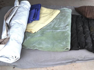

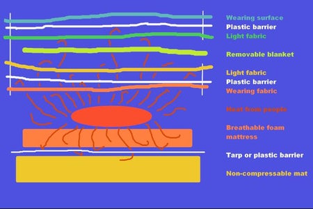

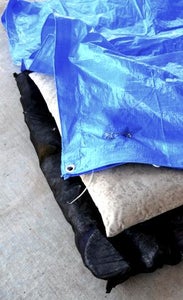

Step 13: Use Your Air Quilt
If you have a solar blanket (a shiny mylar emergency blanket), lay it under one or more insulated mats, shiny side up.
If you can blow through your foam mattress, use a piece of heavy plastic or tarp on top of your insulated mat during cold weather. Then place the foam on top.

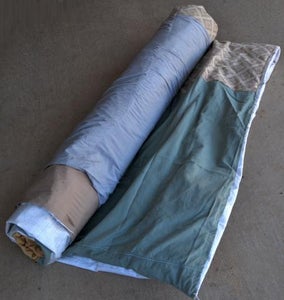

Put a blanket into the pocket of the air duvet cover and tie the loops together to close the pocket.
Wrap up in cotton blankets or quilts, or thermal blankets that let air pass through. Then pull the air duvet up on top.
If weather is freezing for several nights, use a hat and scarf around your head and face. Don't breathe into the inside of your bedding to keep it drier. Shake any frost out every morning, turn inside out and air it in sunshine as often as possible.

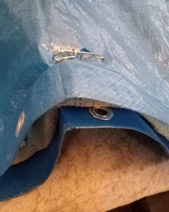

Instant option: temporary air duvets can be made quickly using a folded tarp for the two wearing surfaces heavier plastic film layers. Fasten it with big safety pins (diaper pins).

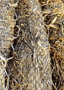

Natural option: if natural fibres are locally available, use straw, chopped corn stalks or rice husks in fabric tubes to fill insulated mats. Channels should be narrower for 13- 26 mm (1- 2") thick mats.
