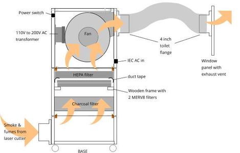

The concept is shown in this diagram. Starting from the bottom, smoke and fumes enter a bottom chamber though a circular vent, large particles drop to the bottom by gravity. A second chamber rests on top of this bottom chamber, the air is drawn though a series of filters in this chamber based on the suction generated by the strong blower fan in the top chamber where a centrifugal blower pulls the air from the laser cutter, through the filters and then ejects it out into the external atmosphere.

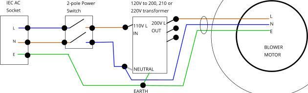

As the fan was a 200V unit I had to extract a 110V to 200V transformer to jump up the 110V to 200V AC.
Have summarized the wiring in this diagram.
The live and neutral wires were connected to the two pole power switch. The brown live from the power switch was connected to the transformers black 110V input and the blue neutral from the switch was connected to the white neutral wire on the transformer. The blue neutral was also connected to the fan neutral. The transformer I had had different outputs from 200V to 240 volts. Decided to use the 200V output, so connected the 200V output to the live of the fan.
All the earth connections were tied to a single point on the transformer as shown here.
In the image the IEC AC input is on the left. The transformer is on the right with the power switch just below it. The transformer was attached to the wood panel with nuts and bolts. Wiring to the power switch is shown on the left.

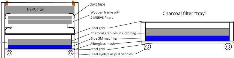

I used a 3 stage filtration approach. First to remove large particles with a matted filter pad and remove chemicals with a mixture of activated charcoal and regular charcoal. 2nd stage to remove smaller particles with regular home air furnace filters and and the last stage to remove micron level particles with a HEPA filter. This staged approach also extend the life of the more expensive HEPA filter.
I had 14 inch square air filters that I decided to use instaed of 15 in square filters which would be better suited for this system. I also had a few 5 inch by 15 inch HEPA filters from a cleanair system that I will use.
Step 6: Making the Middle Filter-holder Chamber
I made the enclosure that would hold the filters. The box was 12 inches tall and would be open to the top and bottom. Bridging the bottom input vent chamber and the top blower chamber.
I added the wooden lip to the top of this filter chamber to create an air-tight seal with the blower chamber.
I joined the 5 inch wide HEPA filters together with air tight joins to create a larger HEPA filter. The HEPA was then wedged into the top of the filter against the wooden lip.
Below the HEPA would be the regular furnace air filters. These were attached to a frame from white wood, to bridge the gap betwwen the 14 inch filters and the 15 inch internal spacing of the chamber.
I used strips of double-sided foam tape to form a barrier and attached two air filters that had been glued together before to this frame. The logic of using two filters is that you get a major improvement if you stagger two filters. The frame with the two filters was pushed against the HEPA filter and held in place with tape.

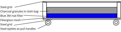

The bottom most filter stage, with the filter pad and carbon filter, were a box made out of 3.5 inch wide MDF that slides into the filter enclosure cube. The bottom of this box is covered with fiberglass window mesh and metal grid used for stucco walls. The mesh and grid were held in place with screws.
A blue filter mat was wedged into the bottom of this box against the mesh.
I had prepared a cloth rectangular bag slightly larger that the inside of the box (from a cushion cover) and filled it with a mixture of regular crushed charcoal that had been autoclaved and commercial activated charcoal granules. Sorry did not take images for the carbon filter. The top of the filter box was covered with another piece of metal grid held with screws.
Also attached eyelets to the bottom of the MDF sides of the box and a nylon tape to serve as a handle for the box to pull out. The assembled box was slid inside and attached to the sides of the filter chamber with a screw from each side of the enclosure.

Step 8: Putting the Three Modules Together and Testing for Suction
Stacked the three chambers on top of each other, plugged it in and did a test with an anemometer. Was surprised at the amount of air this system moved and was also a bit surprised at how relatively quiet the system is.
