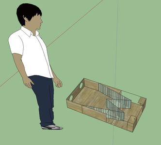

Step 1: Theory
My Basic design is made to be placed flat under my bed.
I arranged the filter in a way which seemed effective for me.
*** Please see step 8 for improvements ***

Step 3: Mesurments
This depends on where do you want to place the Filter.
I made mine flat so it could fit under my bed.
