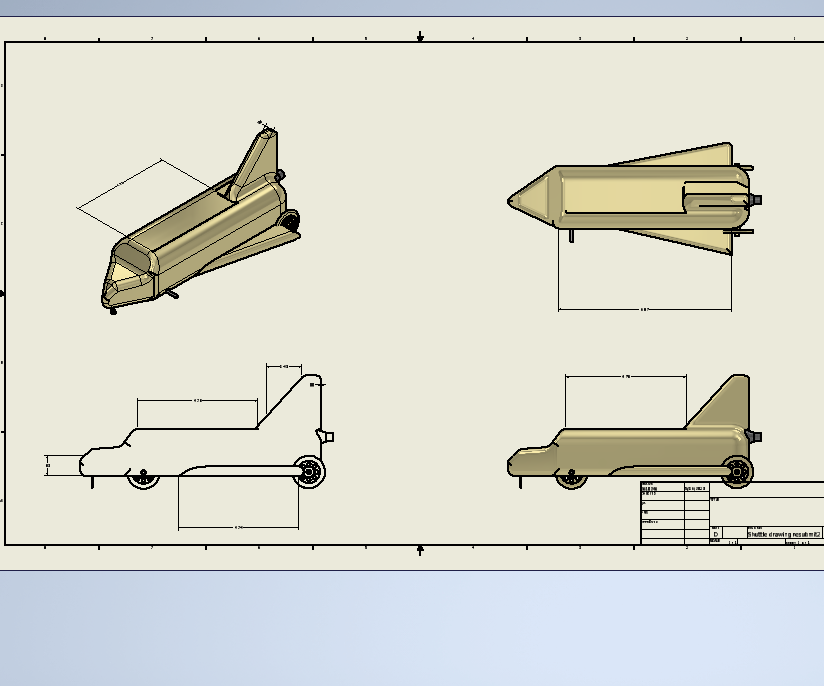

3d printer ( I use the ender 3 pro )
Step 1: 3d Print Your Chassis
First step is to 3d print your car chassis. I printed this part on my ender 3 pro unmodified with the reality cura software. S
Details:
.2 resolution
85% or higher infill density
z hop .2mm
no supports
Step 2: 3d Print Your Ramp
For this ramp i designed i made it in2wo pieces so that you could print it in one go with minimal filament.
use around 30% infill
no supports
