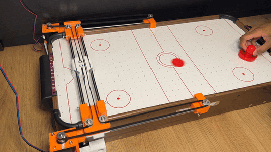

Ever wanted to play air hockey against a computer in real life? Well I have the solution for you - a DIY Air Hockey Playing Robot! It's a bit of fun as the robot doesn't put up too much of a challenge against a human player but it turns out when it's configured just right it can actually be pretty tough to score against.

Step 3: Y-Axis Assembly 1
Take the x_axis_slider and insert a linear bearing into the hole - it should fit securely by itself. Do this again so that you have two of them.
Grab the y_axis_end and attach the x_axis_slider to the underside using M3 screws and fasten using nuts from the other side. It might be tricky to tighten the nuts so using some pliers is recommended.
Once that's done, on the top side place a pulley on each of the two small bumps designed to hold them and attach them to the y_axis_end using M3 screws. The screw should pass through both y_axis_end and then the x_axis_slider part. Do this once again so that you have two.
⚠️ Make sure that the pulleys can turn freely and that the head of the M3 screws touches only the inside of the pulley.
Step 4: Y-Axis Assembly 2
Take the puck_hitter and insert a linear bearing into each of the holes that pass through the side of it. Then, take two of the linear rods and insert them into the puck_hitter.
Line up the rods and then push one of the completed sub assemblies from the previous step onto the end. Secure in place by inserting nuts into the side slots and fasten with M3 screws.
Now everything can be placed on top of the air hockey table to make sure it fits properly - the x_axis_sliders on each end should overhang the table.
Step 5: X-Axis Assembly 1
The next step is to build the x axis that goes on either side of the table.
First, take rod_clip_right and rod_clip_left and attach a pulley to each in the same way as the previous steps.
Once that's done, take the left and right stepper_mount pieces and fasten them to their respective stepper_platform pieces as shown in the images. This should allow for the stepper motors to be put in place and attached using screws.
At this point, take one of the stepper assemblies and attach it to the side of the air hockey table. Depending on the length of your air hockey table you might need to extend the stepper_platform using a stepper_platform_extender.
Step 6: X-Axis Assembly 2
With the y axis sub assembly placed on top of the table, take a linear rod and pass it through first the x_axis_slider and then into the hole in the side of the stepper_mount.
Then push a rod_clip onto the other end. Make sure the linear rod is sandwiched tightly and then insert M3 nuts into both the rod_clip and the stepper_mount and tighten with M3 screws.
Repeat this again for the other side and then finally place pulleys onto the stepper shafts and tighten.

Step 8: Adding the Belt
At this point I would recommend putting the belt in place, which should wrap around the pulleys in a H-shaped configuration. The ends of the belt should fit into some holes I designed on the puck_hitter. The fit is a bit fiddly so it may take a few tries to get the belt to be tight.
⚠️ I recommend cutting the belt at the very end and leaving it long just in case some adjustments need to be made
