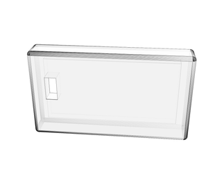

Step 1: CNC-machining and Preparing Parts
Firstly, you should check the design attached to the project (SolidWorks 2016), prepare DXF or any other file for CAM. The longest thing is drilling holes - it took about 7 hours.
For milling MDF was used 12mm end mill, for drilling was used 3mm drilling bit. On the last layer you have to make a slot for installing the aluminium border, for this you should use 2mm end mill.
