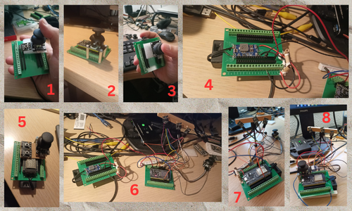

Step 3: Wiring and Prototyping
I've tried to document the entire process of prototyping, wiring, testing, and debugging to make it easier for you to follow along. Here it goes:
1,2,3: Figuring out how to mount everything in the most compact way possible.
4: Testing the regulator.
5: Testing how to fit the joystick.
6: Testing with all connected (buttons and joystick).
7: More testing with all connected but in a single board.
8: Mounting the joystick and testing again :)
As you can see, I try to approach this step by step to maintain control and avoid missing anything. There were times when everything stopped working due to a faulty connection, so be patient.
I’ve tried to focus on keeping everything organized while considering the quick replacement of components. If something breaks, it should be easy to replace. For example, the expansion board ensures that if the ESP32 loses functionality, it can be easily swapped out. The same applies to the buttons and joystick. The only component difficult to replace would be the regulator; I couldn't find a better way to position it since I had to solder the cables directly. In hindsight, a better idea might have been to solder cables with a female pin connector or something similar, to the regulator. And put male pin connectors to the cables going to the regulator and coming from the expansion board.
