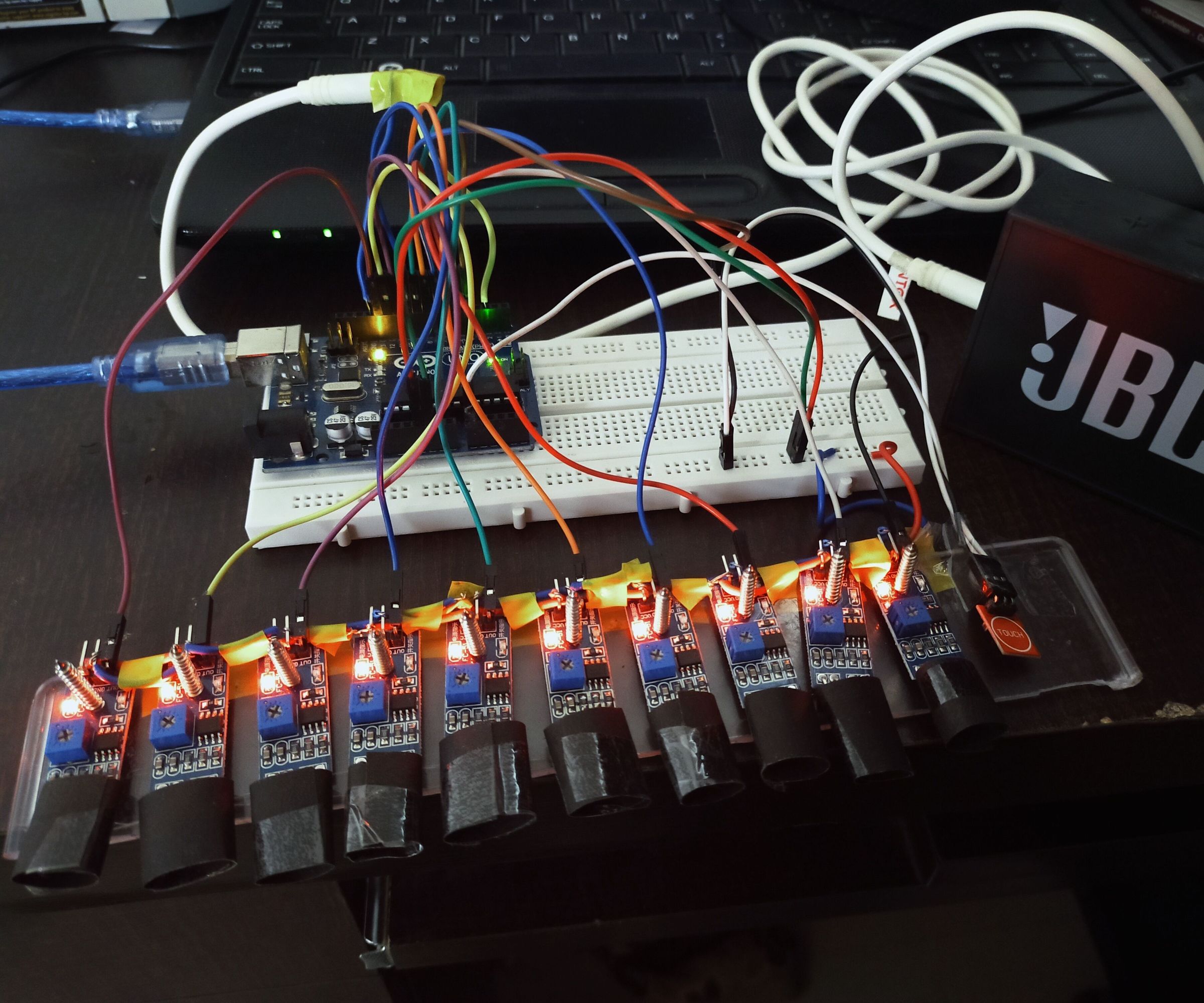

Step 1: Mounting Ir Sensors
Ir sensor modules are equipped with a mounting hole at the center. You could use the hole to fit sensor with a tight screw or you can just use glue to stick it. I have used an acrylic sheet as base and drilled holes in acrylic with proper markings where each hole was 2 cm apart. Do not arrange the sensors too close to each other as it may ruin your piano user experience.
Step 2: Wiring the Sensors
Connect all the positive terminals of sensors using a wire and solder(optional). Also connect all the ground pins of all the sensors. Now finally, you need to connect output pins from Ir sensor to Digital pins of the microcontroller board. In my case, it is Arduino uno. Remember that , when an obstacle is detected Output from the sensor is low. So, if you want to connect led as indicator in the circuit, connect the negative terminal to sensor output and positive to 3.3v positive rail of Arduino uno.
Step 3: Connecting Output
Now connect the the digital output pin to the positive terminal of buzzer/ speaker. And connect the negative terminal to the ground of Arduino uno. If you are using a buzzer/ speaker which requires a high voltage, it is recommended to use a npn bjt because it has very fast switching and can run smoothly with variable frequency inputs from Arduino. Also make sure that if you are using high power buzzer, don't use power supply from arduino. Instead use some external source but in my case power consumption is low so I am using directly from Arduino.
Step 4: Adjusting Range of Ir Sensor and Covering With Black Carsheet Rolls
Step 5: Code for Micro-controller Board
The code begins with defining frequencies for which we want output of buzzer/speaker. Then we define pins which we are going to use for sensor inputs. Then we setup our pins in void setup(). In void loop() I have just used conditional statements because code becomes simple and is good enough for present needs.
