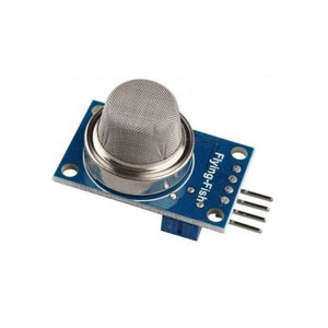

  • MQ135 sensor module

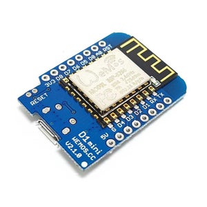

  • WEMOS D1 Mini ESP 8266

Step 1: Prepare the Components
As written above, prepare those components. You can get them on your local electronic components store or online!

Step 3: Code ESP
After assembling the circuit in breadboard. Code and upload it to Visual Studio Code.
The ESP code can be seen here: https://github.com/RichieCheniago/sensoresp8266mq135.git

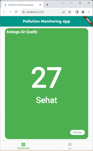

Step 6: Code Application
In the application, we use flutter as the framework and dart as the programming language. It is also more convenient to connect Flutter with our database that is Google Firebase. The picture above shows the design of our application. However, create your design as creative as possible. Feel free!
The application code can be seen here: https://github.com/clem1205/trspecmr.git
