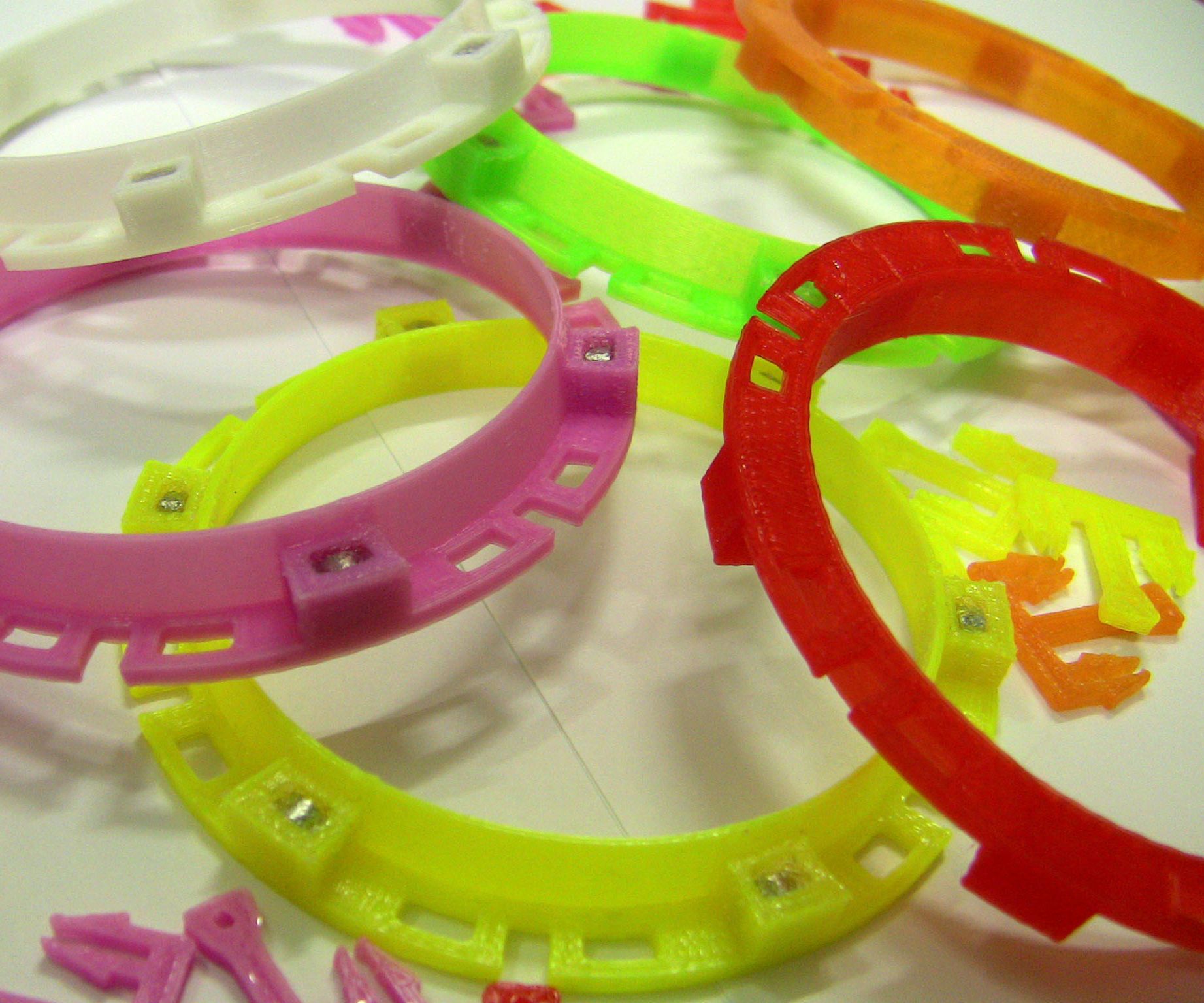

Step 4: Flashing Light - 3D Print
Flashing light are always good :)
You can spread them around the ring so it will be noticeable at night or even indicate when the rig is armed and ready to fire so people can keep a safe distance from it.

Print all the files from this link:
https://github.com/romansky/apollo/tree/master/3d-prints/flashing-light
Push the small gear (motor-gear.stl) to the motor's shaft. If you can't to it by hand try using clamps.
Next we need make a reflector to reflect some of the light. Cut small piece of aluminum foil to match the inner section of the bering-gear.stl. Apply glue inside the gear and gently push the foil inside.
After the glue dried you can cut the excess foil with an x-acto knife.
Push the gear to the bearing and then to the base.stl
It is recommended to print the bering-gear.stl with an opaque filament so the light won't penetrate to the other side.
The last step is to print the cap with transparent filament. You can put an aluminum foil at the top of the cap.
