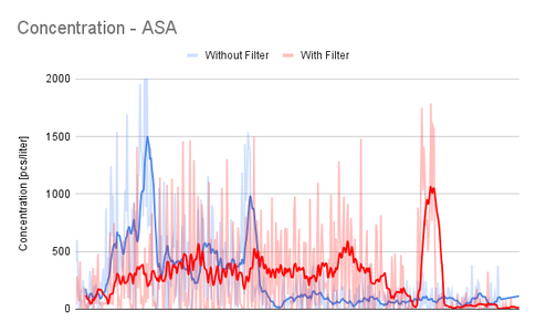

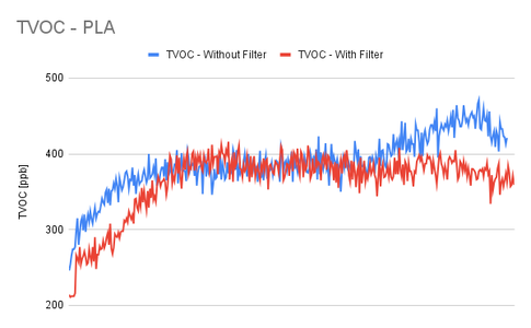

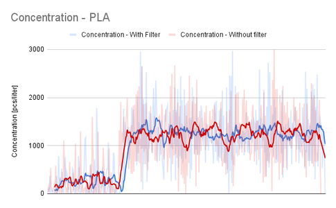

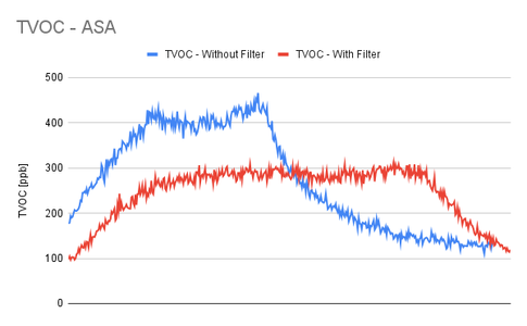

I am planing to use this tool to check air quality in areas around my house, as well as test some projects I have made in the past to see how effective they are.
The goal of this project is to make a small, portable station that can easily be moved around my house to check and monitor air quality.

Step 6: Test It Out!
Now that it all works and you totally understand every single line of code, thanks to my incredible explanation above, you are ready to give it a test.
I decided to stick mine into my printer enclosure and run a few prints some with ASA and some with PLA I also have a Bento Box air filter in there so I ran one of each with and without the filter. Lets look at the data in the next step.
Step 7: Simple Data Analysis
Now that you have collected a bit of data with the unit, copy the file onto your computer. Right click on it and choose, rename, and change the .txt ending to a .csv file. This will make it so Excel will automatically open it or it can be imported into google sheets easily. It should have a semi decent header row and then all the data below it. You will need to use the ‘text to columns’ feature to break the data apart if you care too.
To actually use the data, I am just selecting the time column and the dust column to make a little graph. I think this gives a good idea over time.
This large type of data set really should be analyzed using something other than a spreadsheet but for me this gets the point across. Maybe I will look at writing some python to do some more robust analysis.
The graphs attached to this step are the same ones I go over in the video so check that out for what is happening, but, briefly I ran the same print, same gcode, twice, once with the filter on and once with it off. The data, attached in a csv, was then lined up so that I could compare the two prints. I only really looked at the concentration and the TVOC and skipped over the eCO2, temp, and relative humidity. (to convert from a CSV to a spreadsheet you can use the 'text to columns' to split it at the , if it doesn't open correctly).
