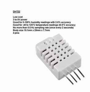

DHT22 : The DHT22 is the more expensive version which obviously has better specifications. Its temperature measuring range is from -40 to +125 degrees Celsius with +-0.5 degrees accuracy.

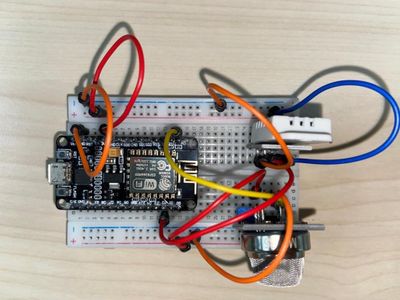

Step 2: Connecting Components (DHT 22)
Although DHT 22 (temperature and humidity) sensors are quite sluggish and simple, they are perfect for hobbyists who want to log some simple data. The capacitive humidity and temperature sensors are the two components that make up the DHT sensors.
The DHT sensor have four pins, VCC, GND, data pin and a not connected pin which has no usage.
From left to right
  • VCC
  • Signal
  • NC Not connected
  • GND

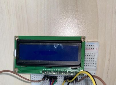

Step 3: Connecting Components (LCD 1602A)
How to connect LCD Pin to ESP32 Pins:
The LCD has 16 pins :
PIN01-VSS to GND
PIN02-VDD to 5V
PIN03 V0 to 10K Pot (Middle pin)
PIN04 RS to GPIO19
PIN05 RW to GND
PIN06 E to GPIO23
PIN07 D0 to NOT USED
PIN08 D1 to NOT USED
PIN09 D2 to NOT USED
PIN10 D3 to NOT USED
PIN11 D4 to GPIO18
PIN12 D5 to GPIO17
PIN13 D6 to GPIO16
PIN14 D7 to GPIO15
PIN15 A to 5V
PIN16 K to GND
Step 4: Connecting Components (MQ 135)
  • The VCC pin of the MQ135 Gas Sensor is connected to the 3.3 volts pin of the NodeMCU Module.
  • A0 pin of the NodeMCU Module is connected to AOUT pin.
  • The ground of the Gas Sensor is connected to the ground of the NodeMCU ESP8266 Wifi Module.

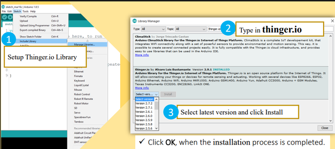

    Step 4: Open Arduino IDE to setup Thinger.io library .To do this go to Sketch>Include Library>Manage Libraries. Search for thinger.io and install the latest in the library.

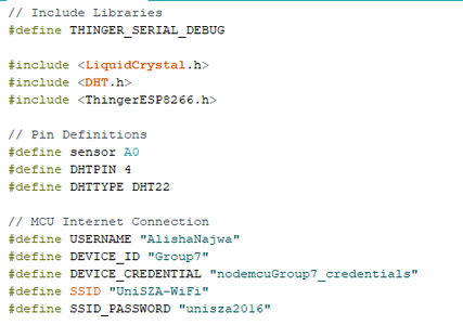

    Step 6: The Source Code in Arduino IDE
    // Include Libraries
    #define THINGER_SERIAL_DEBUG
    #include<LiquidCrystal.h>
    #include<DHT.h>
    #include<ThingerESP8266.h>
    // Pin Definitions
    #define sensor A0
    #define DHTPIN 4
    #define DHTTYPE DHT22
    // MCU Internet Connection
    #define USERNAME "AlishaNajwa"
    #define DEVICE_ID "Group7"
    #define DEVICE_CREDENTIAL "nodemcuGroup7_credentials"
    #define SSID "UniSZA-WiFi"
    #define SSID_PASSWORD "unisza2016"
    ThingerESP8266 thing(USERNAME, DEVICE_ID, DEVICE_CREDENTIAL);
