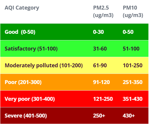

Note:- PM2.5 or PM10 data on online websites is represented as AQI or ug/m3. If the PM2.5 value is 100, then if it is represented as AQI then it will fall in the 'Satisfactory' category but if it is represented as ug/m3 then it will fall under the 'Poor' category.

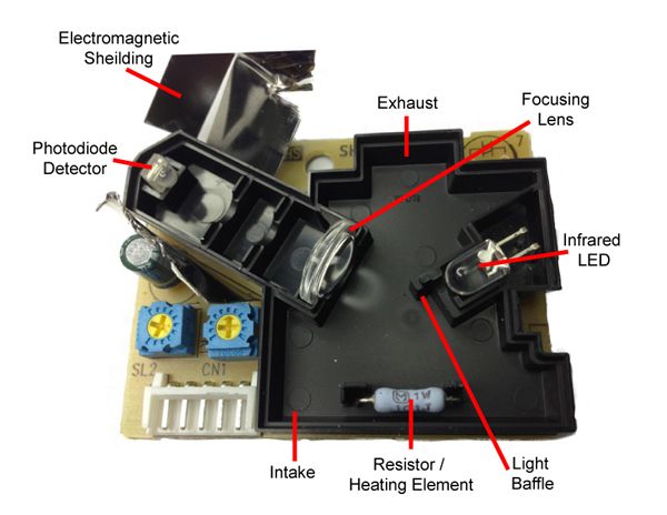

Step 3: PPD42NJ Dust Sensor

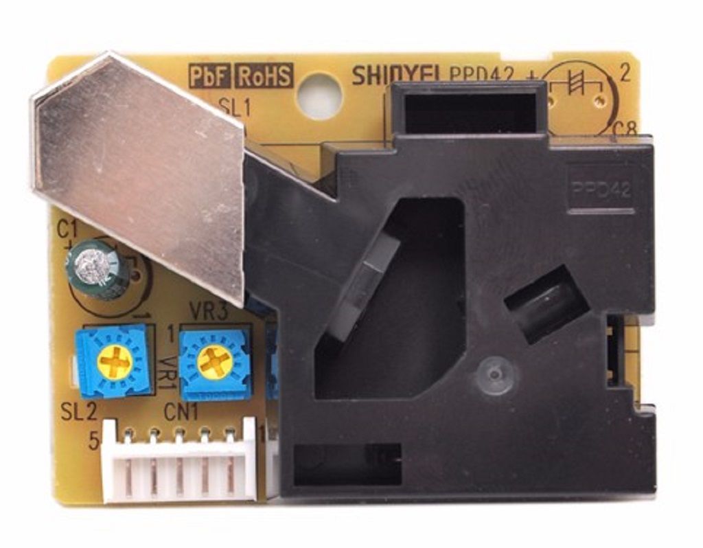

Based on the light scattering method, it detects airborne particles continuously. Pulse output that corresponds to concentration per unit volume of particles can be obtained with using an original detection method based on light scattered principle similar to the particle counter.
Front side
On the front, it has 2 pots labelled VR1 and VR3 that have been already factory-calibrated. The IR detector is covered under the metal can. Interestingly there’s a slot by the side labelled SL2 which is unused.
Back side
The circuit consists largely of passives and an op-amp. RH1 is the resistor heater which, in theory, could be removed to save power if there was some other method of air circulation.

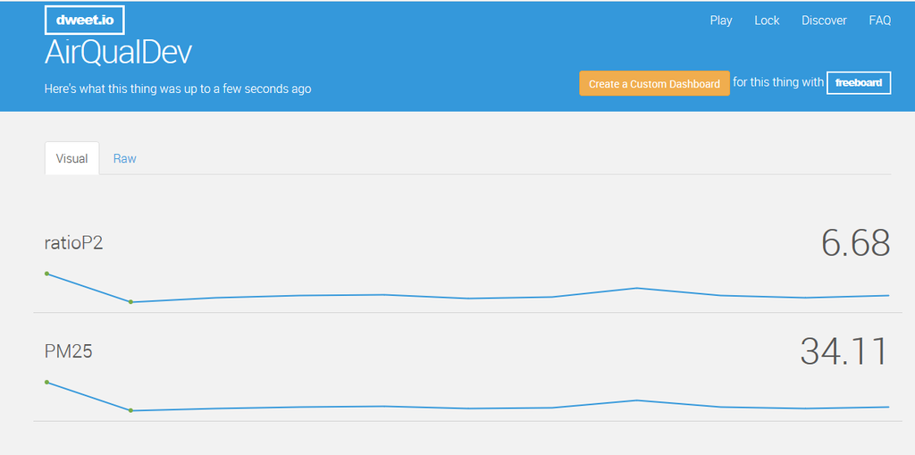

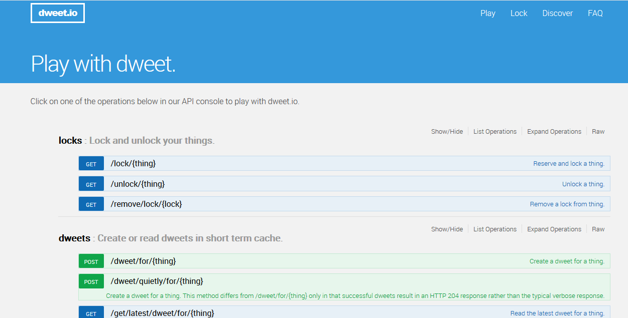

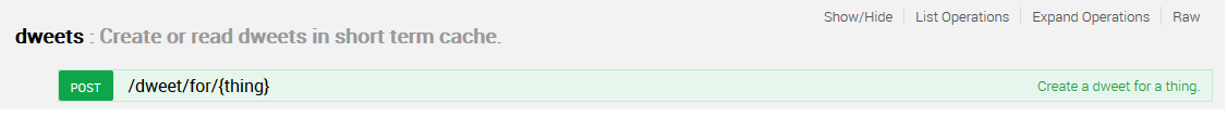

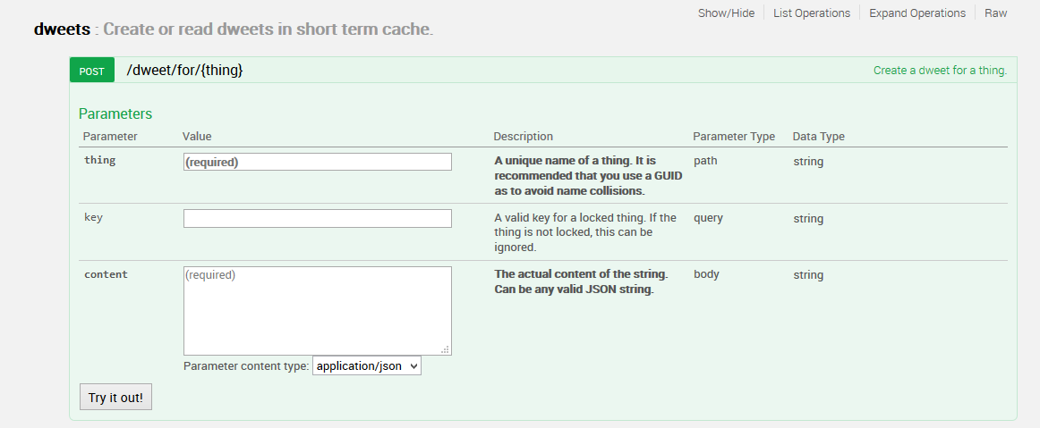

Step 6: Dweet.io
dweet.io enables your machine and sensor data to become easily accessible through a web based
RESTful API, allowing you to quickly make apps or simply share data.
1. Go to dweet.io
2. Go to dweets section and create dweet for a thing
3. You will see page like this. Enter a unique name of a thing. This name will be used in Particle photon.
Now, we are done with dweet.io setup

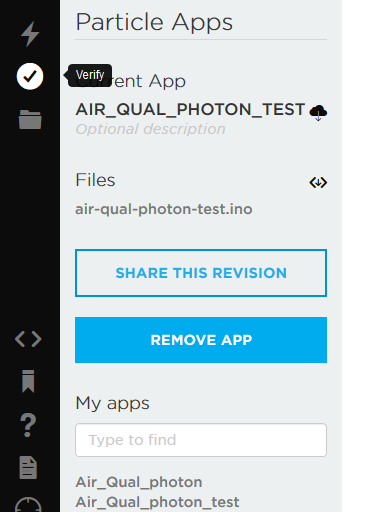

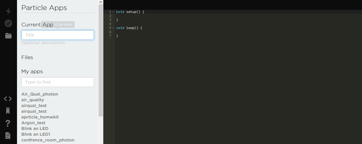

Web IDE
Particle Build is an Integrated Development Environment, or IDE that means that you can do software development in an easy-to-use application, which just so happens to run in your web browser.
- To open build, login to your particle account and then click on Web IDE as shown in image.
Once you clicked you will see console like this.

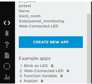

To create a new create app, click on create new app.
To verify the program. Click on verify.

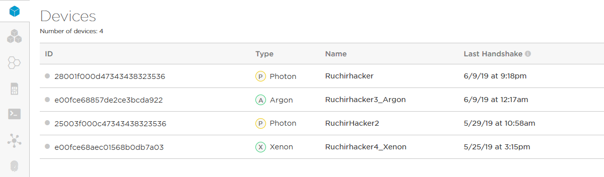

To upload the code, click on flash but before doing that select a device.If you have more than one device you have to make sure that you have selected which of your devices to flash code to. Click on the "Devices" icon at the bottom left side of the navigation pane, then when you hover over device name the star will appear on the left. Click on it to set the device you had like to update (it won't be visible if you have only one device). Once you have selected a device, the star associated with it will turn yellow. (If you only have one device, there is no need to select it, you can continue.

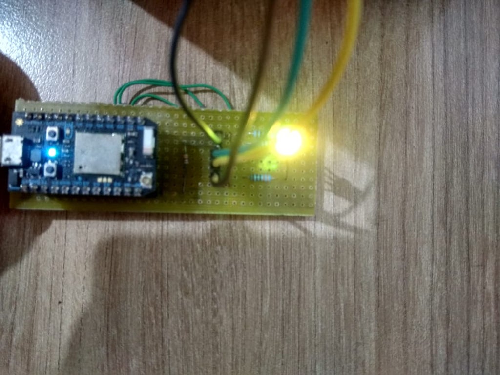

Step 8: Connections
Particle Photon ==> PPD42NJ sensor (placed in vertical direction)
GND ==> Pin1(GND)
D6 ==> Pin2 (Output)
Vin ==>Pin3(5V)
GND ==> 10k resistor ==> Pin5 (Input)
Particle Photon ==> RGB LED
D1 ==> R
D2 ==> G
D3 ==> B
GND ==> Common Cathode (-)

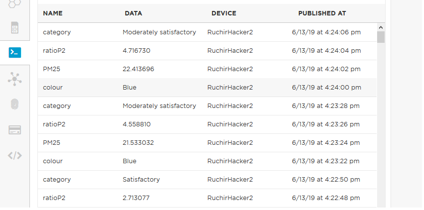

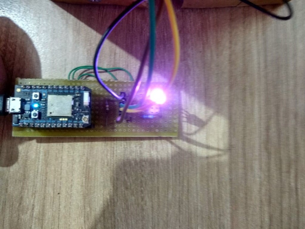

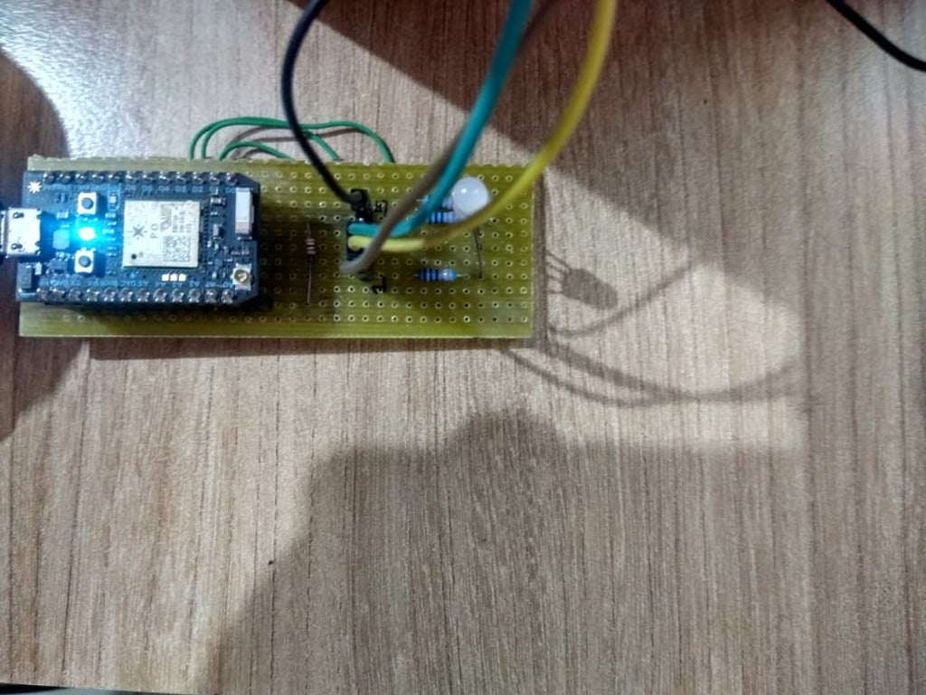

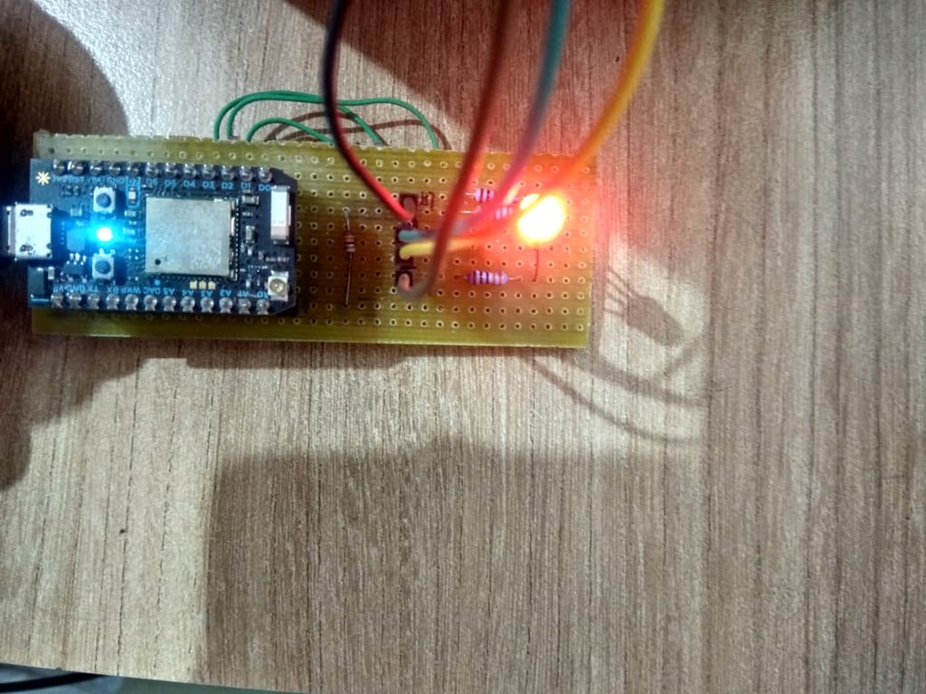

Step 10: Result

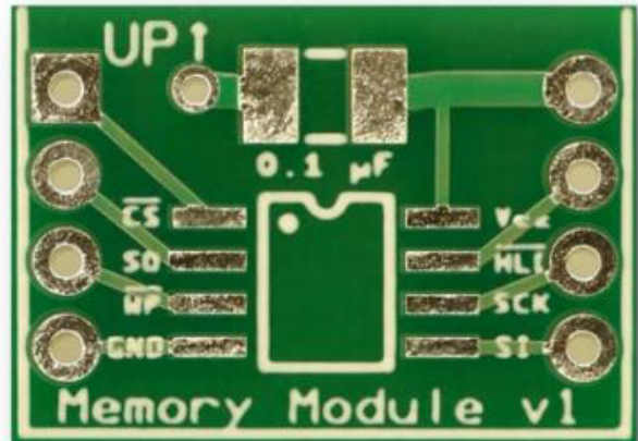

Pads
A pad is a small surface of copper in a printed circuit board that allows soldering the component to the board or we can say points on the circuit board where the terminals of the components are soldered.
There are 2 types of pads; thru-hole and SMD (surface mount).
- Thru-hole pads are intended for introducing the pins of the components, so they can be soldered from the opposite side from which the component was inserted.
- The SMD pads are intended for surface mount devices, or in other words, for soldering the component on the same surface where it was placed.

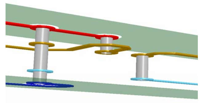

Via
A via is a plated hole that allows the current to pass through the board. It is used in the multilayer PCB to connect to more layers.
Types of Via
- Thru-hole Vias or Full Stack Vias
When an interconnect must be made from a component that is located on the top layer of the printed circuit board with another that is located at the bottom layer. For conducting the current from the top layer to the bottom layer, a via is used for each track.
Green ==> Top and bottom soldermasks
Red ==> Top layer ( conductive )
Violet ==> Second layer. In this case, this layer is used as a power plane ( i.e. Vcc or Gnd )
Yellow ==> Third layer. In this case, this layer is used as a power plane ( i.e. Vcc or Gnd )
Blue ==> Bottom Layer ( conductive )
2. Blind vias
blind vias are used, which allows a connection to be made from an external layer to an internal layer with minimum via height. A blind via starts on an external layer and ends on an internal layer, that's why it has the prefix "blind". In multilayer system designs where there are many integrated circuits, power planes ( Vcc or GND) are used to avoid excessive routing for power rails.
To know if a certain via is blind, you can put the PCB against a source of light and see if you can see the light coming from the source through the via. If you can see the light, then the via is thru-hole, otherwise, the via is blind.
It is very useful to use these kinds of vias in printed circuit board design when you don't have too much space for placing components and routing. You can put components on both sides and maximize the space. If the vias were thru-hole instead of blind, there would be some extra space used by the vias on both sides.
3. Buried Vias
These vias are similar to the blind ones, with the difference that they begin and end on an inner layer.

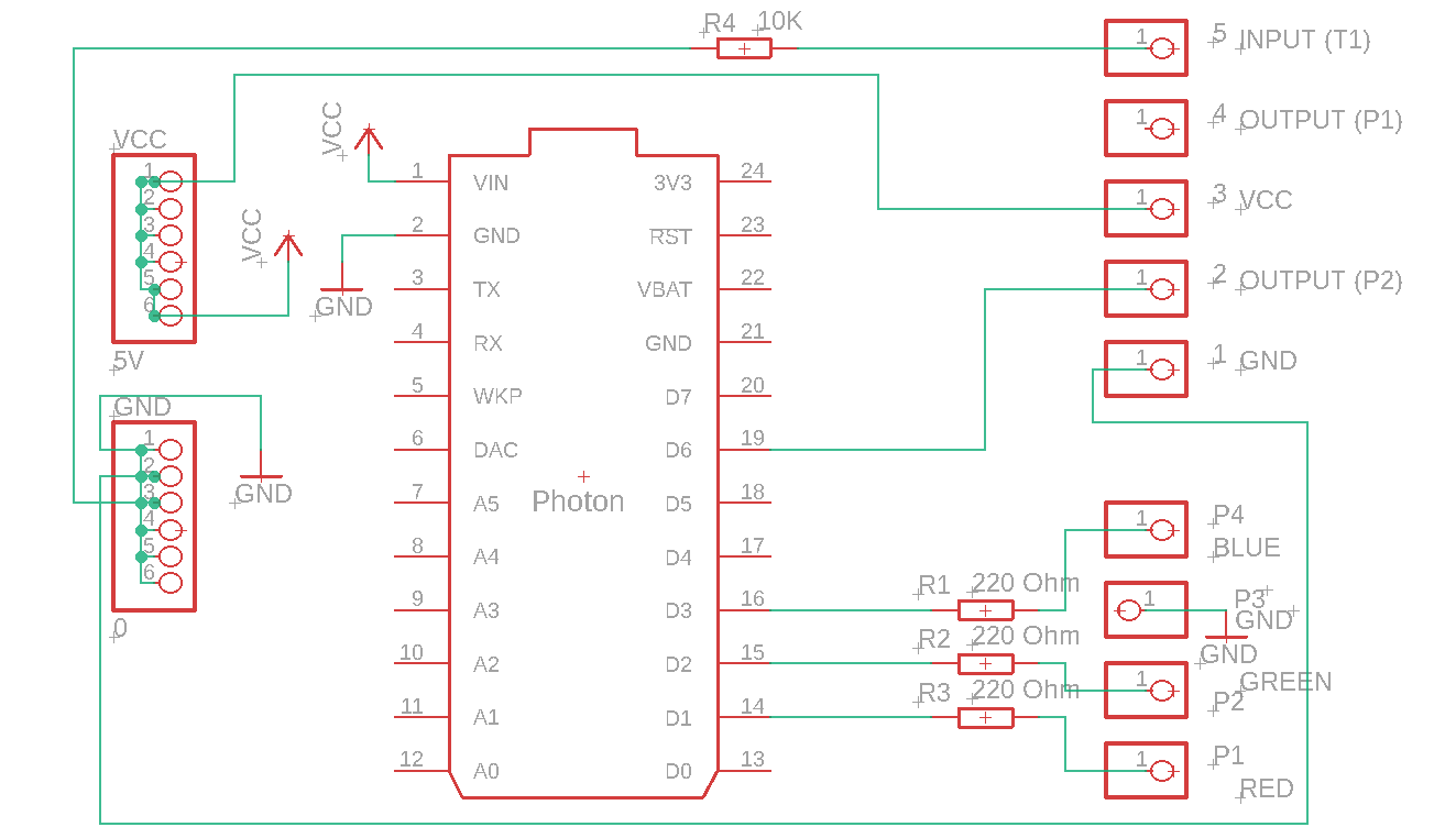

Make a schematic diagram

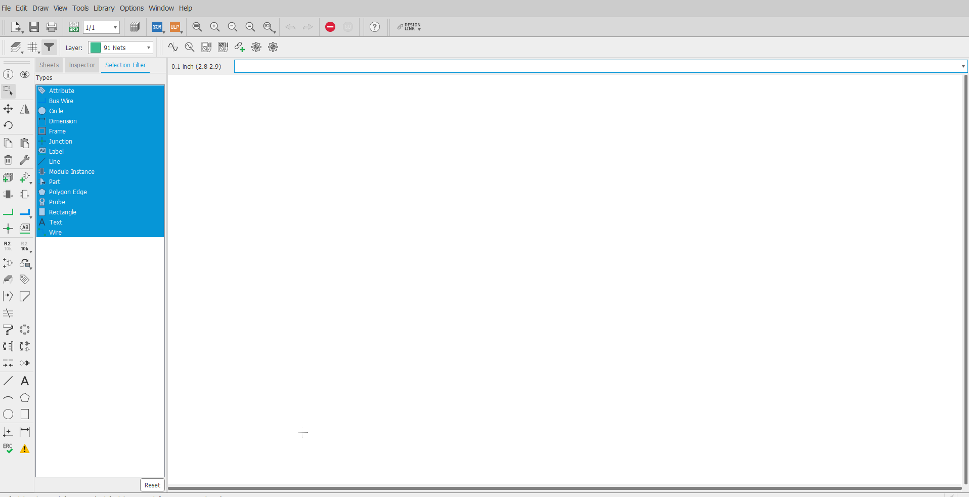

1. To make a schematic go to File ==> new ==> Schematic You will see a page like this

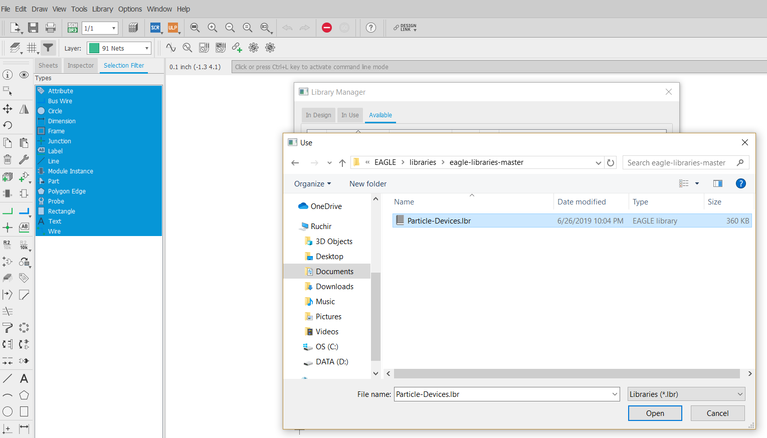

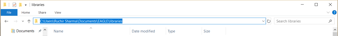

As there are no Particle parts so we have to add Particle devices libraries.

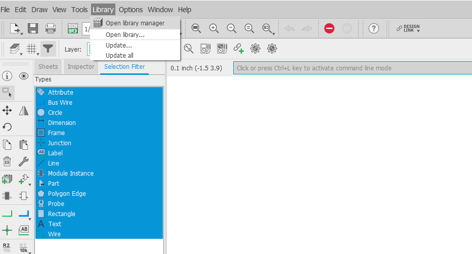

Next, after downloading it move it to the folder C:\Users\.....\Documents\EAGLE\libraries
In Eagle open Schematics go to Library ==> open library manager
you will see a page like this, go to option Available and browse to the library particledevices.lbr
After opening it click on use
Now, we can see particle devices.

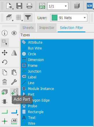

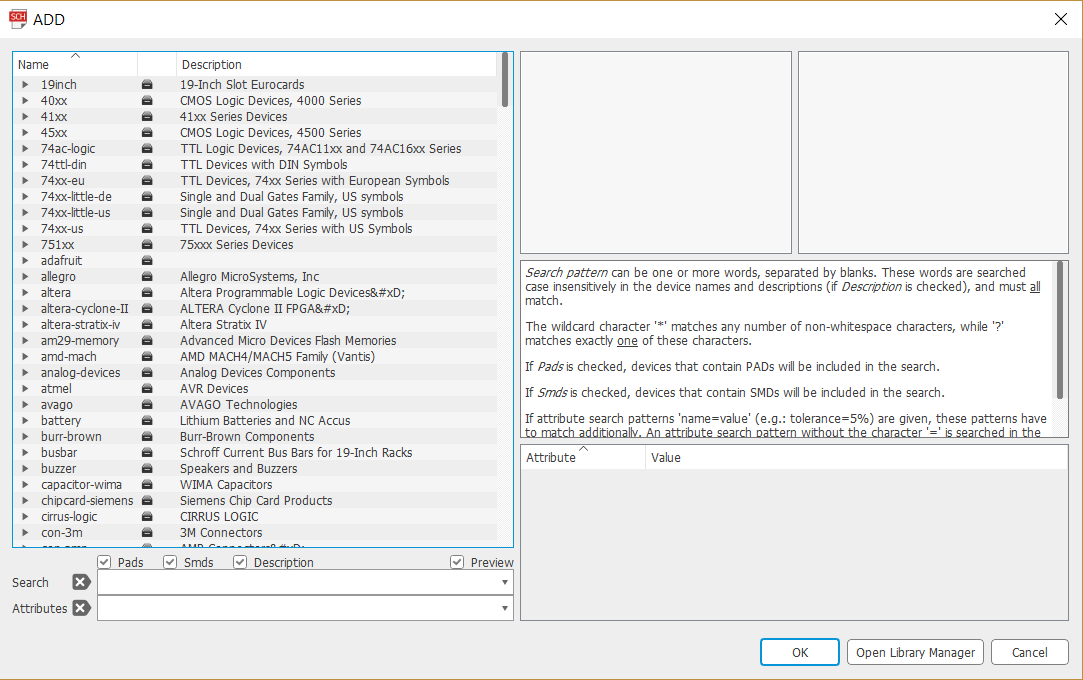

Next step is to make a schematic for that we use add part as shown in figure
When you click on add part you will see a page like this
The components we needed are Particle photon, headers, resistors, GND, Vcc. Search components in add parts
- For a resistor, there are two types US and EU. Here I am using a European one
- For header search header and you will see lots of headers choose according to yours.
- For ground search gnd
- For VCC search vcc
- For Particle Photon search it
Once components are selected next step is to join it together for that you can use line or nets or both.
Join it as shown in the image below
Next step is giving name and value.
For giving names select name and then click on the component to which you wanna give a name.
For giving values select value and then click on the component to which we want to give a name.
After that check ERC

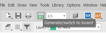

Once checked we are done with Schematic. Next step is to switch to boards from schematics
When you shift to boards you will see all the components at the left side of the board so you have to move it to the PCB board. For that click on the group and select all the components and use the move tool to move it.

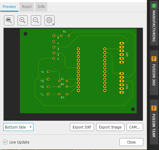

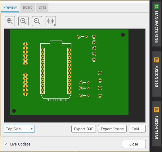

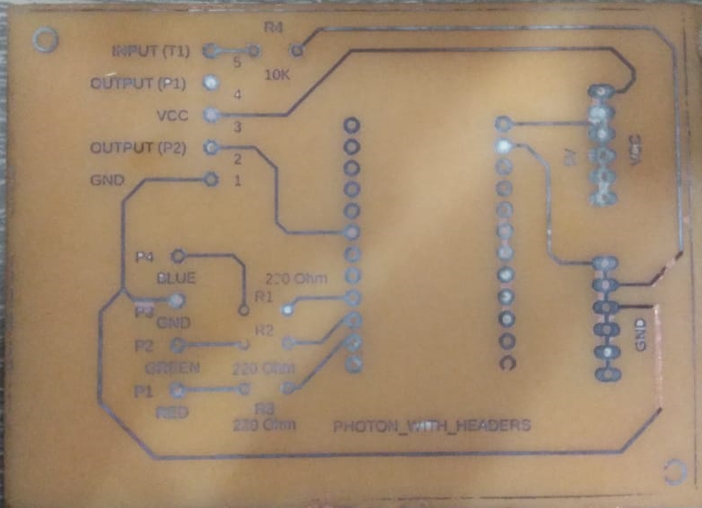

Next, save the board with any name, check DRC to check errors. If no error we are good to go ahead.
To see a preview of the board go to manufacturing.
Now we are done with the board part.

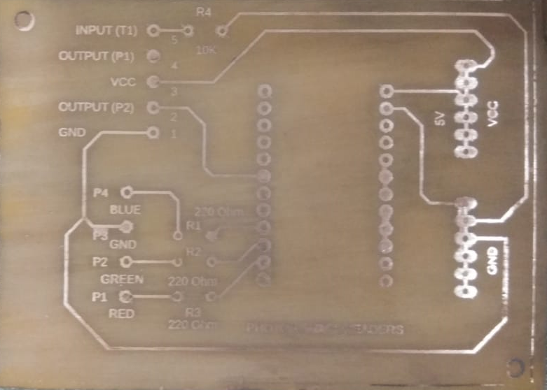

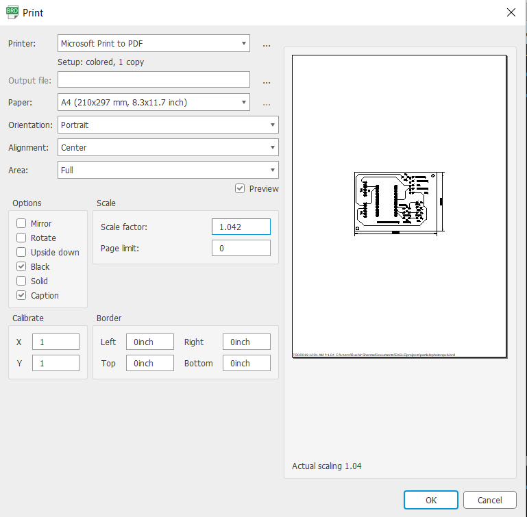

Next step is to print the ckt on glossy paper. For that click on print, you will see a page as shown below.
- Select black in option, if you are using multiple layers then you also have to select mirror.
- Select scale factor 1.042 After that save it to pdf or print it.
After printing the ckt,

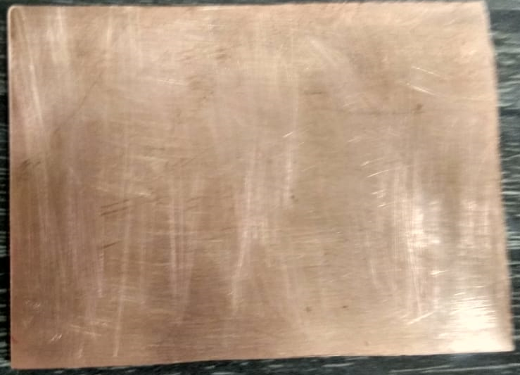

1. Remove the oxidation layer using sandpaper (400) use a light hand.
2. Clean it using isopropanol or propan-2-ol or if you want you can use thinner also.

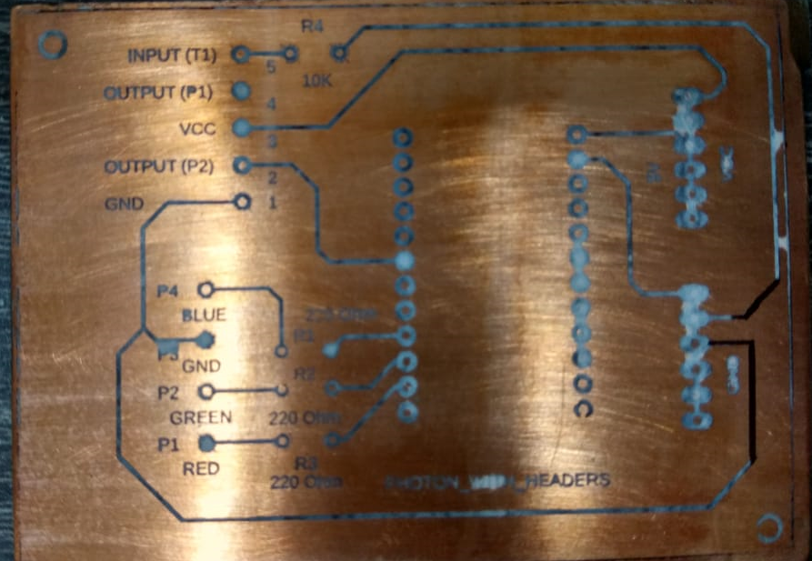

3. Place the printed ckt on FR4 sheet using paper tape.

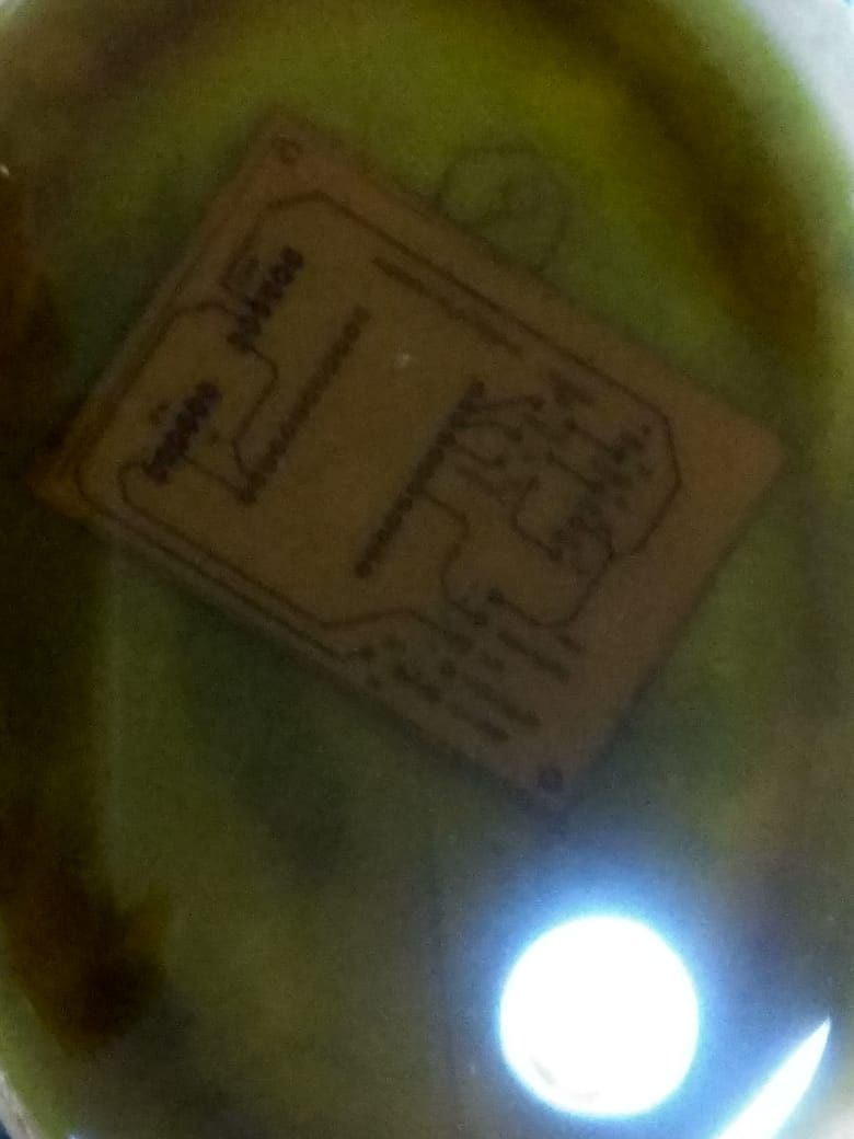

4. Heat it using heating iron (5 -10 minutes) so that ckt will print on FR4 sheet. Soak board in water for 2-3 minutes. After that remove the tape and paper.
5. Place it in ferric chloride solution for 10 minutes to remove access copper then wash it with water.
6. Remove the layer using sandpaper(400) or Acetone.
