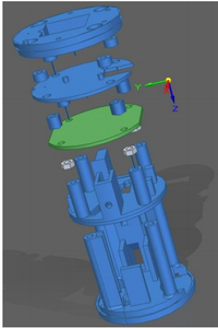

This is a mini satellite which allows us to see air pollution in all places. We installed here temperature sensor, gyro, and more things which let us know actuall wheather. Construction is strong and only thing that can break is case. As you can see at the photos there is a parachute. If you have drone, you can drop it from any heigh. On SD you can read height, temperature and more! I tell you more on each step what sth is and how it works.
Step 2: 3D Print
All links below, there are in .3mf
We had done a lot of test and we printed the best can. As you see, there are a lot of damages but we had tested it throwing from heights. Don't worry, .3mf is complete and things won't broke and they looks better.

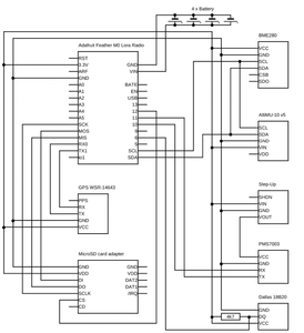

Step 3: Soldering Circuit
When can is printing, you can start soldering. SD, Altimu and BME you need to connect on one soldering plate 45x45mm. On the first floor there are betteries, PMS and temperature sensor. On second floor there are Adafruit and limit switch. Third floor includes soldering plate with Altimu etc. Last floor is reserved to GPS module.
Edit: there is a mistake in circuit, you need to connect behind Adafruit and batteries a limit switch (NC entrance)

In can there are four batteries connected parallel to power input. You need to get copper plates and squeeze them out to fit in batteries. When you got it, using hot glue stick them into this places. Plus is at smaller, second floor/part of can. you need to connect both minuses and both pluses. From minus you need to run the cable through the slot of the post to Adafruit.
Step 5: Building Up Everything
Firstly, you need to stick limit switch on second floor like on picture using hot glue. Remember to And this is last thing you need hot glue. Seriously, if you dont throw it from window at third floor you dont need to use glue. But if you have a drone you can stick PMS and Adafruit to plastic and put behind batteries and PMS a small sponge. Adafruit connect to plastic using 4 small screws. Above is Altimu etc. Next is small plastic plate, GPS and lid. Everything twisted with M4 screws.
