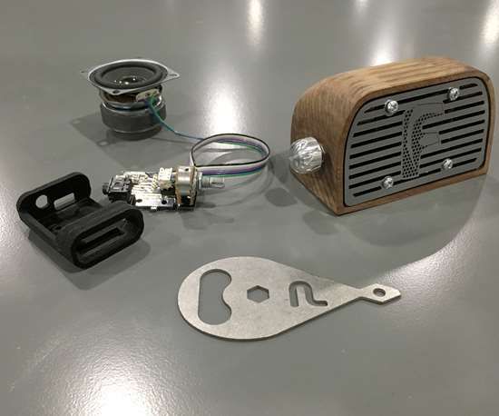

The device the team came up with was the speaker pictured below. The idea was to showcase some of the different manufacturing methods that were possible with Fusion 360 and EAGLE.

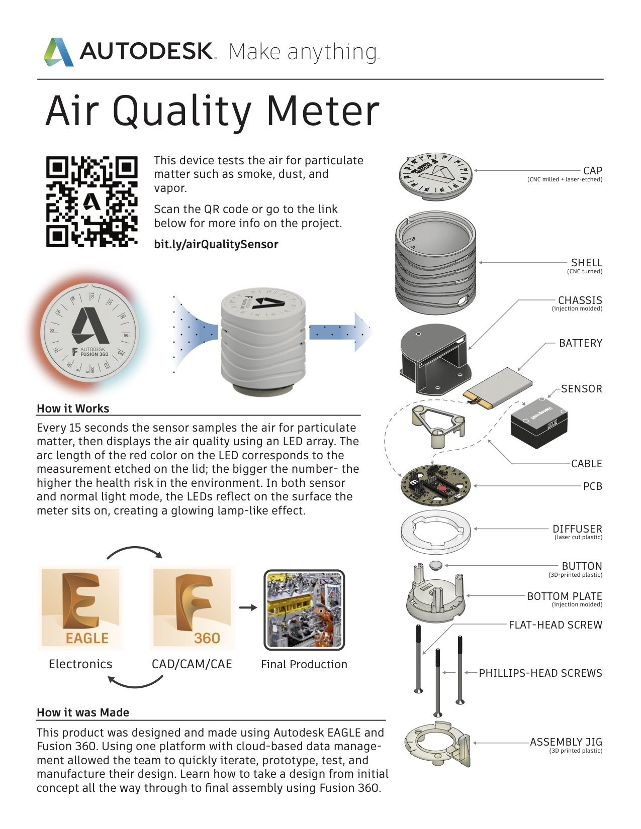

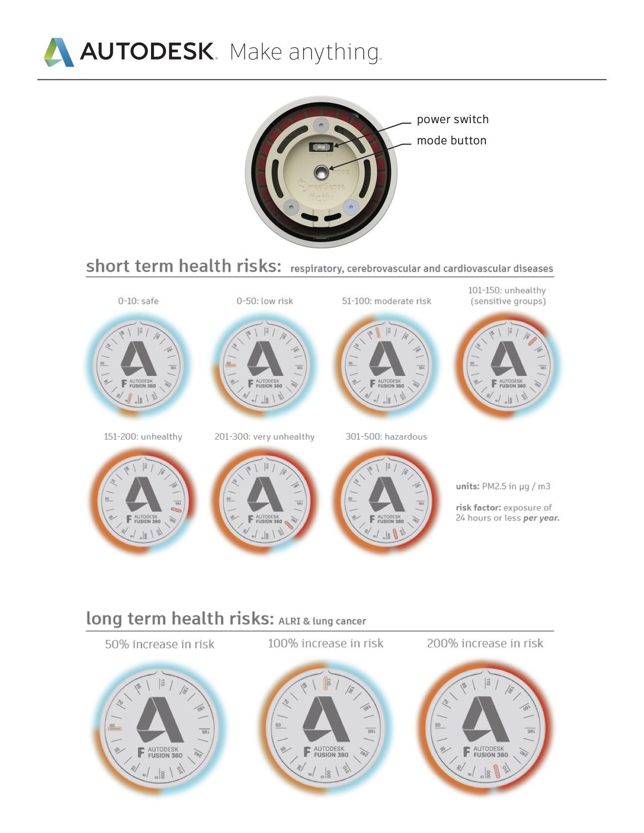

The picture framed device in the video above is the production version of an air quality meter the company developed for long-term use in Africa. They were placed in the homes of people who cook indoors with coal, wood, etc. These fuel sources create a dangerous level of PM2.5 (particulate matter 2.5 microns in diameter, we'll get into that later), and the device gives feedback in the form of e-ink displays standing in for the baby's lungs in the graphic. The idea is to make a clear warning- this is dangerous for your baby, take him outside while you're cooking!
Collaboration
Having spent some time with Taylor Sharpe from Sweet Sense, I approached him about a collaboration. We brainstormed about possible ideas for a device that hit all of the criteria listed previously, and Taylor suggested we make an air quality meter as a consumer product, similar to the one he developed for Africa.
Not only would this be a useful device for anyone (you'd be surprised just how bad your air quality can be when you're cooking, for example), but it could also be instrumental in raising awareness about the problem from a global perspective.
