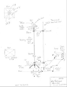

This does not really have a wrong or right way to put together since it is so adjustable.
  • Down bar/shaft into base
  • I do recommend to put the 7/16 rod down shaft in the base (7/16 inch OD steel rod for down rod 48 inches)
  • It was a friction fit - no glue
  • Cross Bars to downward shaft
  • About 30 inches apart put 2X - 3/8 and 7/16 outside diameters adjustable swivel rod holders CLAMPS
  • on down rod/shaft
  • Put 3/8 inch OD steel rod for cross rods 2X to 12 inch lengths
  • In each clamps
  • the direction should be opposite of the base
  • Cross Bars to downward Rotating shaft
  • Put on the opposite end of the 3/8 rods 2X - 3/8 and 1/4 outside diameters adjustable swivel rod holders CLAMPS - one on each cross bar
  • Put the 1/4 inch OD with 3/16 ID steel tube - used automotive brake line need 1 inch each
  • in each clamp
  • Rotating shaft Lower half
  • #10 - 24 thread rod - 36 inches
  • Install fan
  • Put Upper Nut #10 - 24 threaded
  • Washer 3/16 inner diameter
  • FAN BLADE WITH BLADES POINTING DOWN (CUP OF BLADES WILL FACE DOWN)
  • Put Lower Nut #10 - 24 threaded
  • Tighten upper and lower nut to pinch fan blade
  • Put second lower Nut #10 - 24 threaded This is the jam nut to secure fan blade and so it does not twist off in rotational motion
  • Install thread rod up the lower clamp
  • install thread rod up the upper clamp
  • Rotating shaft Upper half
  • On the upper part of #10 - 24 thread rod - 36 inches - above the upper clamp
  • Put 2X washer 3/16 inner diameter
  • Put 1X Nut #10 - 24 thread down
  • Put #10 - 24 thread rod connector ONLY THREAD TO HALF OF THE CONNECTOR - THE OTHER HALF MUST RECIEVE THE THREADED DOOR HANDLE
  • tighten nut to the rod connector - jam nut
Light oil the contact points of the rotating shaft especially at the top clamp point of two washers.
This should not be a pinch between the upper and lower points of the rotating threaded rod.
Place candle holder on top of the connector the put the door handle threaded rod thru hole and tighten
Step 7: Adjustments
  • There should not be a pinch between the upper and lower points of the rotating threaded rod.
  • a modest gap between the lower clamp and the fan - should be present
PLEASE NOTE THIS IS A FRICTION SHAFT (NO BEARINGS) SO SOME PLAY IS GOOD
  • USING A LEVEL CHECK THAT THE TREAD ROD IS STRAIGHT UP AND DOWN
ADJUSTMENTS TO ALL THE CLAMPS WILL NEED TO BE DONE.
I FOUND THAT HAND SPINNING THE THREADED ROD TO OBTAIN THE SMOOTHES ROTATION.
WHEN YOU FIND THE SWEET SPOT THE FAN WILL SPIN FREELY AND COME TO A GRADUAL STOP.
  • 2X - 3/8 and 1/4 outside diameters adjustable swivel rod holders CLAMPS
  • 2X - 3/8 and 7/16 outside diameters adjustable swivel rod holders CLAMPS
Also note why I put adjustable feet on the bottom, balance is important, so you might need to move the feet to be level and so the base does not rock on the floor.
I USE THE DOWNWARD 7/16 STEEL ROD TO MOVE AND NEVER THE TREADED ROD.
MOVE SO THE FAN IS OVER THE FLOOR REGESTER.
