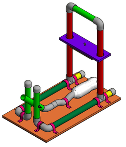

A weight (wood block) drops on a 2 liter bottle. The bottle is connected to a PVC pipe through a flexible hose. Air from the bottle propels a ping-pong ball out through the pipe. Weight height and launch angle are adjustable.

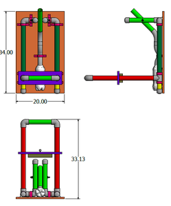

You will be building to this drawing.

Cut plywood for the base of the launcher. We used 1/2" thick to keep the weight down. Keep in mind the overall size requirements (1m x 1m x .8m) during this step.
Step 7: PVC Pipes
Cut pipes as shown. You might want to hold off on the 3” long pieces until final fit check.

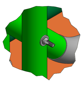

Drill 5/16” clearance holes through the center of 3 of the 12” pipes

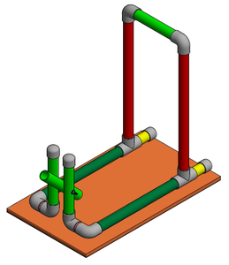

Step 9: PVC Assembly
Assembly the PVC pipes/fittings as shown - don’t glue yet! For the launcher tube, feed the 5/16” threaded rod through the holes. We used rubber spacer for the inner interface. Flat washers and wing nuts were used on the outside. Note that this rod also is used for the ball stop. Optional – add another through rod to the a few inches from the bottom. This will give the vertical sections more support.

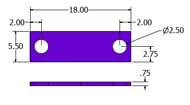

Depending on PVC fit, the dimensions might not match the drawing. Remove the top piece and use it as a template for the slider holes on the 1x6. Use a drill and hole saw to make these holes. Note that it took us two iterations for this step. For the first try, we had holes that were only slightly bigger than the outside diameter of the PVC pipe. This seemed nice until the trial phase. The board would catch and not fall about 25% of the time. We increased the diameter to 2 ½” and it now works every time.

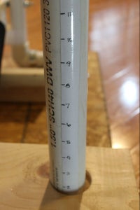

A paper ruler covered in clear packing tape was added to the rear to mark the weight height. An optional approach would be to use a sharpie to mark the tube directly.

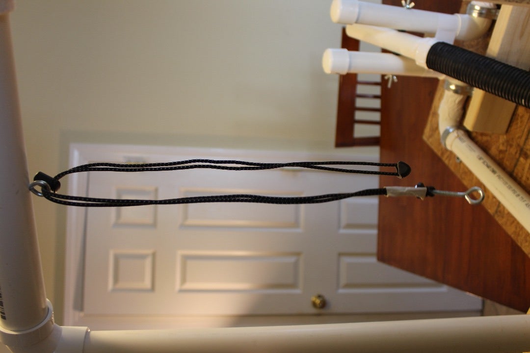

Step 21: Update 1 - Added a Trigger Mechanism
Add two eyehooks to the weight. Pull pin used for the release.
Step 22: Update 1 - Added a Trigger Mechanism
A cord/latch was used from an old book bag to lock in the weight height.
Video of the trigger:
