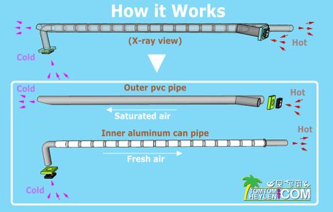

Step 3: How It Works

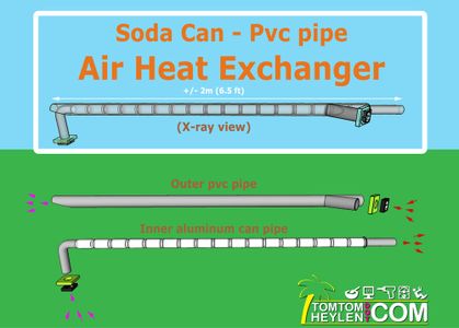

The air heat exchanger consists mainly of an aluminum pipe made from soda cans that sits inside a wider pvc pipe.
The cold fresh air is being pushed trough the aluminum pipe to entering the room.
The hot saturated air is being pushed trough the pvc pipe in the other direction to leave the room.
Since aluminum is a very conductive material, the heat/cold will be transferred upon each other while keeping the fresh air separated from the saturated air resulting in fresh air entering the room without loosing to much heat.

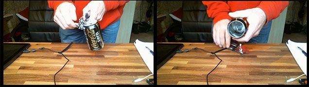

We use a can opener to open up the top of the soda cans. About 12 or so cans is what we need. Together the length of the cans should be a bit less then the length of the outer pvc pipe.

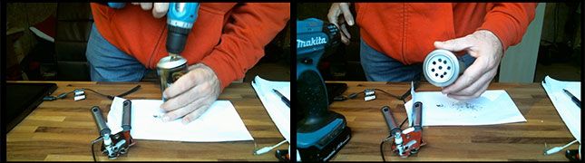

Use a drill with a 10 mm steel drill bit and bore 5 holes in the bottom of each can.
Calculating the total surface of the bore holes in the bottom of each can
The total surface of the holes should be equal to the space between the two pipes.
To calculate this I use an example with a drill bit of 10 mm.
The big pvc pipe has a diameter of Ø 70 mm (radius 35 mm). The soda cans have a diameter of Ø 66 mm (radius 33 mm).
Area pvc pipe = π r2 = 3.1415 . (35 . 35) = 3848 mm2.
Area aluminum pipe = π r2 = 3.1415 . (33 . 33) = 3421 mm2.
Now we subtract the aluminum pipe from the pvc pipe.
3848 – 3421 = 427 mm2.
The holes we bore in the bottom of the cans should have a total of 427 mm2.
We calculate the surface of 1 hole with a drill bit of 10 mm (radius 5 mm).
π r2 = 3.1415 . (5 . 5) = 78 mm2.
Now we divide the 427 mm2 by 78 mm2.
427 / 78 = 5.4 rounded to 5
So we need to bore 5 holes with a drill bit of Ø 10 mm.

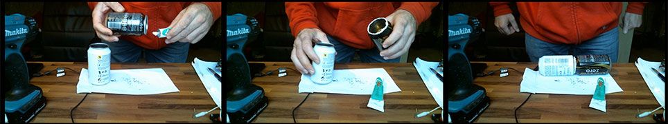

Now glue together the bottom to the top of each can with the aluminum glue. I used 2 strips of wood to lay the cans on to make sure the pipe is 100 % straight.

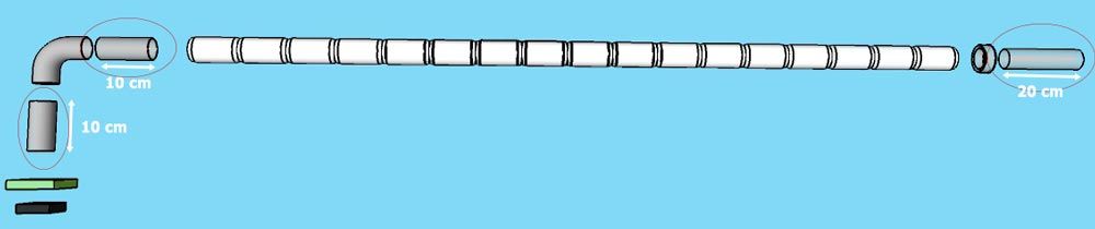

With a grinder or metal saw cut 1 piece of 20 cm and 2 pieces of 10 cm from the Ø 5 cm (1.96 in) Pvc pipe.
Step 9:
Put one end of the 10 cm pvc pipe in the opening of the top can from your aluminum pipe and glue together to make sure there are no fits.

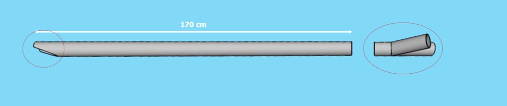

Use a grinder of metal saw to cut the Ø 7 cm pvc pipe at a length of 170 cm.
At one end of the pipe, cut away diagonally a piece about 10 cm long. This is to prevent rain or snow getting in to the pipe.
Glue the pvc y-piece on the other end of the Ø 7 cm pvc pipe.

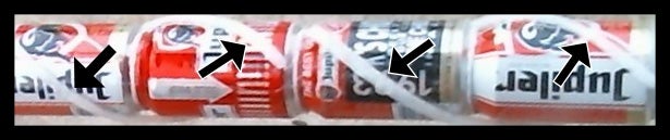

Cut a bunch of stripes of +/- 1 cm width and +/- 15 cm long out the foam sheet.
When your aluminum pipe is hardened out, glue on each can 2 stripes diagonally over the can on both sides. Make intervals of 45° on each can to make sure the air can travel trough the pipe.

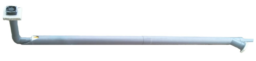

Now it's time to slide the pipes in each other.
Gently slide the aluminum pipe with the pvc end in the larger pvc pipe starting at the y-piece.
Now glue the pvc pipe reducer to the end of the aluminum pipe and slide it in the y-piece.
Glue the 20 cm small pipe to the reducer and the pvc elbow and the 10 cm pipe to the other end on the aluminum pipe.
Step 13:
Your heat exchanger is nearly ready now.

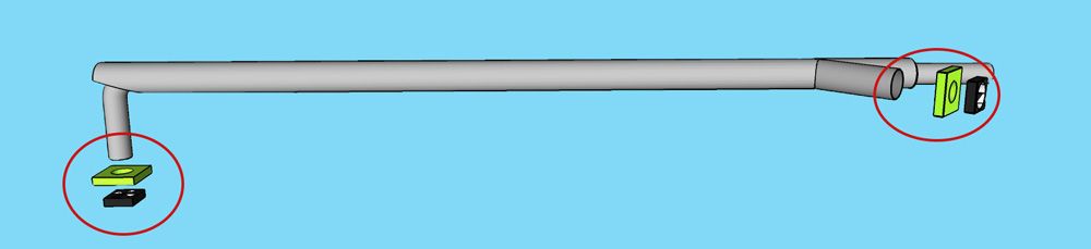

In center of the polystyrene boards, cut out a circle with a diameter of 5 cm.
Glue the fans to the center of the boards with you glue gun and glue one board to the opening in the y-piece and the other to the opening of the Ø 5cm pipe near the elbow.

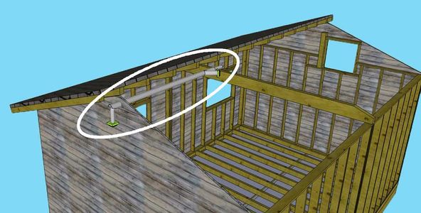

Step 15: Installing
The best place to install your heat exchanger is under the roof since that is the warmest place in the house.
In case you using it to keep your house cool, install it down the bottom of the house.
