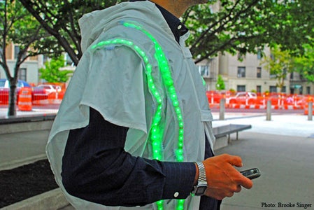

AirCasting Luminescence
AirCasting Luminescence uses a IOIO microcontroller connected to the AirCasting app over Bluetooth to illuminate LEDs in response to the sensor measurements received by the AirCasting app: green for low intensity, then yellow, then orange, and red for high intensity. AirCasting Luminescence was developed to communicate sensor measurements without the normally required reference to a screen interface and to spark interaction between AirCasters and people located in their immediate vicinity. AirCasting Luminescence . . . make a fashion statement with your sensor measurements!
