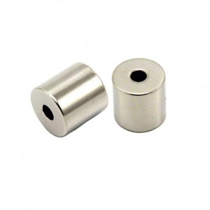

  7. Of course neodymium magnets. (Warning: Neo magnets are very strong and fragile. They can pinch your fingers if you are not careful and can shatter. Cylindrical ones are a bit easier to manage.)

Step 4: Make Triangle Center and Glue in the Magnets
For the triangle centers of the structure,you can use math, tinkercad, or just cut them to 36-40mm if you followed my other dimensions. Find the center of the triangles and then use a compass to create drill points. The are drilled on the high side of the 12 degree drill table. Drill the centers of your triangles to the size of your Neo magnet diameter. I later found out it's easier if you don't drill all the way thru for later glue up.
