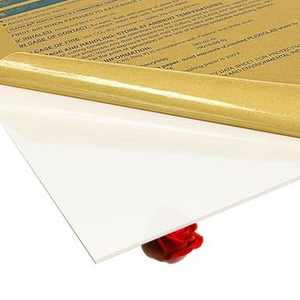

Step 4: Creating Panels
I started by purchasing a 7328 Opaque White Acrylic sheet. This will be for the top layer and run about $60 for a 24 x 48” sheet. To complete the top panel you'll need just one of them and you'll be left with a little bit extra if you cut it right, to be able to test on.

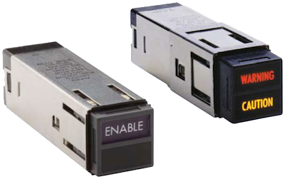

Step 16: Korry Switches
Korry Witches are a type of momentary/latching switch that are only found in Airbus model aircraft. It is essentially a switch with a light up led display that can be adjusted to indicate on/off functionality.

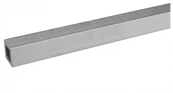

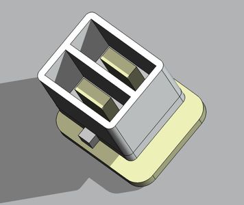

Step 17: Design
To start, I grabbed a premade fusion file of the 3D printed prototype off of Hobby Tech Gear whom was previously mentioned and used it as a reference. I ended up scouring the internet and local hardware stores for some 3/4x1/32 inch tubing which would end up acting as the casing for the part but failed to find it anywhere in the US. I ended up settling for 1/16 inch tubing which forced me to downscale the whole unit.
Step 18: Design/ Fusion
I uploaded the file to Fusion and began the tedious process of downscaling every corner and side dimension of the actuator to compensate for the new 1/16 inch size frame.
Step 19: 3D Print
Finally I was able to export the file to Cura and the print machine for manufacturing. You will end up needing 116 total Korry switches to replicate the amount in a real overhead panel. You are shooting for the finest print possible so that later when it comes to the movement between tubing an filament, there is little resistance and friction. This may take longer but in the long run is most definitely worth it.

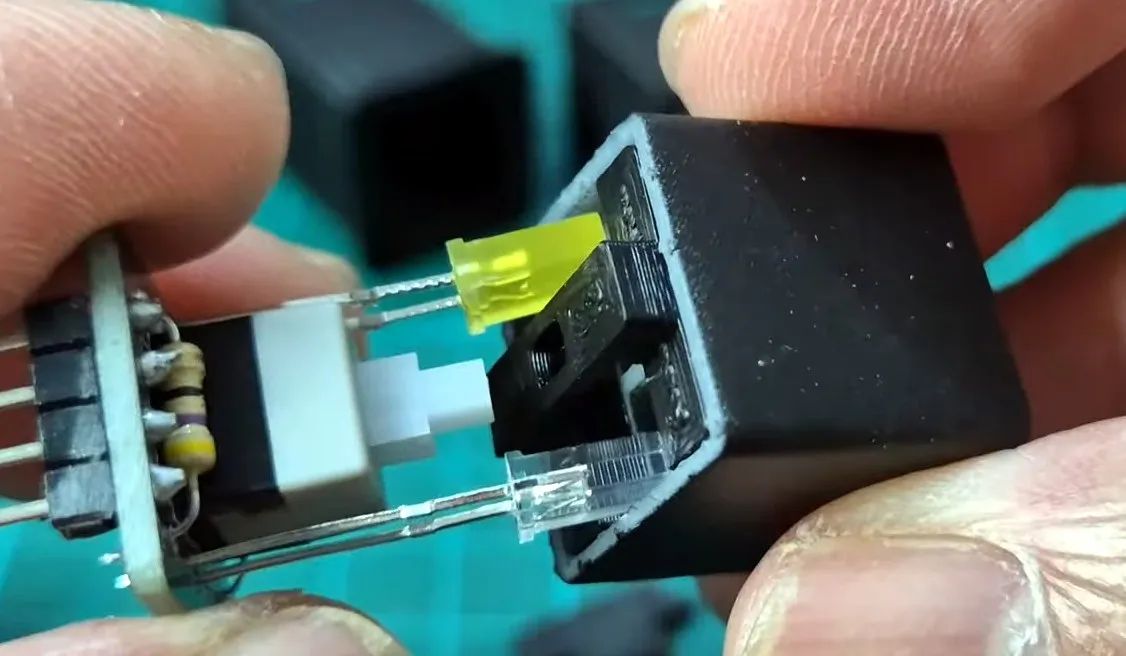

Step 21: LED/ Switch Fitting
Next we will insert the two LEDs on opposite ends of the PCB board, in a way that will fit precisely into our actuator. In between the LEDs will sit our switch that will be soldered in via the six prongs as centered as possible. I found it easiest to solder the resistors onto the LED before feeding them through the board so you can tell where the wires will catch on the actuator and make adjustments accordingly. Then you can superglue the PCB onto the underside of the aluminum frame to fit it into place.
