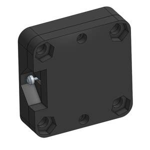

Introduction: Aircraft Panel Clock - Casio MQ-24
I had a gap to fill in my glider's panel, and an old Casio watch lying around...
You will need:
A Casio MQ-24 watch (cheap, available everywhere, reliable, and loads of different faces to choose from).
Four M4 thread-lock nuts.
Four M4 x (16mm + panel thickness) pan-head machine screws. Sorry Americans, you're on your own converting this one.
Two M2 x 4mm cap-head machine screws.
A 35mm (or 1 3/8", if you must) drill bit for the panel cutout.
A 4.5mm (or 3/16") drill bit for the mounting holes.
The STL files and a printing filament of your choice.
The provided cutout template.

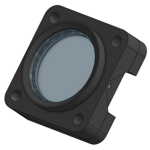

Step 6: Install the Glass Into the Front Piece
Push the glass into the front of the front piece. If your printer is well-tuned, it will be a push fit. Don't use superglue, unless you want it to look like that Airfix Spitfire canopy you made when you were 9.
Step 7: Install the Face/movement Into the Front Piece
Slot the whole face (remember, the stem should be back in by this point) into the back of the front piece, and place the white disc over it.
Step 8: Attach the Back Piece to the Front Piece
Screw the back piece to the front piece using the two M2 screws.
