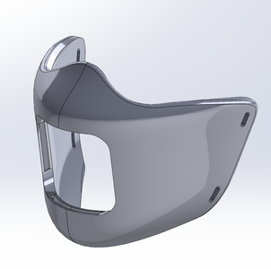

Step 1: Print the Frame
Make sure to print this in PLA with the frame's jawline and chin touching the plate so the supports can work its way around the frame and inside the cheek bone so the print's structural integrity holds as it prints! I used 200mm/s with a brim bed adhesion and tree supports with a breakaway distance of 0.5mm for my print.

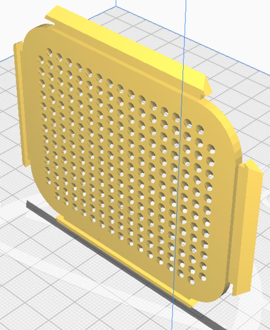

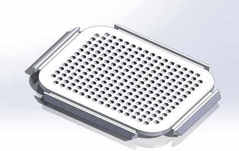

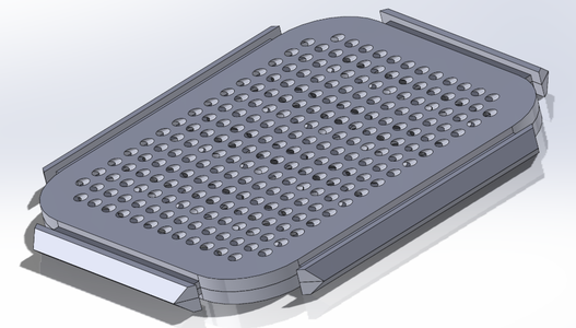

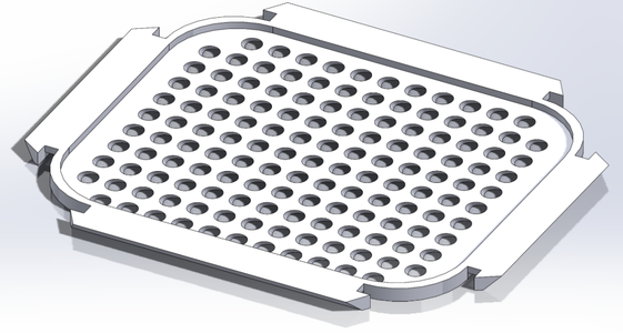

Step 2: Print the Mesh
This mesh is the TPU used to redirect both the nasal and oral exhales to deflect downwards either at 30 degrees or 60 degrees. I found the highest success of keeping the airflow from traveling forwards with the 30 degrees as it deflects most of the air down in front.

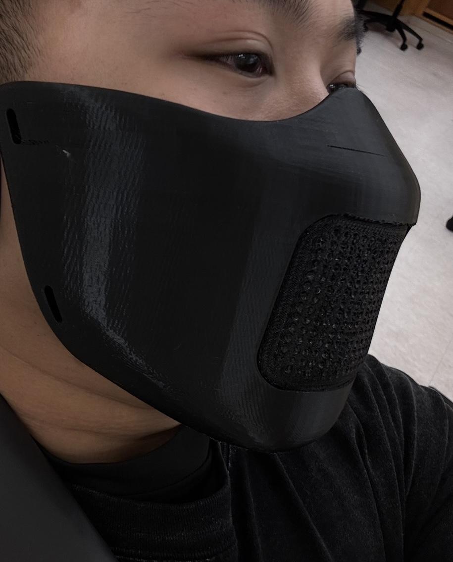

Step 3: Insert the Mesh Into the Frame
Ensure that the perforated mesh has the holes angled downwards when installing the mesh. Ease the Mesh fins into the slots in the mask mouth hole and push them in one side at a time. It should fit seamlessly with the frame and hold well as long as the TPU has no thermal warping during its print.
Step 4: Add Headband Strap
Adjust the strap till its snug and comfortable and now you won't have to deal with having it get stuffy in your mask and worry less about when you sneeze without the reduced airflow when you need to take a breath.
