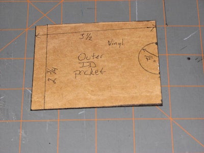

Step 2: (Optional) Make Templates
These templates will make it easier to mark your fabric and vinyl. You can use these templates to maximize the use of your fabric.
1) Back cover: 4.5" x 9.25"
2) Inner pocket: 3.5" x 8.25"/5" (see picture for slant)
3) Outer ID pocket: 3.5" x 2.75"
4) Inner credit card pocket: 2.5" x 4.5"
I used an empty Diet Coke case for the cardboard to make these templates.
On the 3) Outer ID pocket template, mark (but do not cut) a semi-circle off set by 0.25". This provides access to the ID. The offset is because one side of this pocket will be covered by the binding tape.

From the stiff cardboard
- one (1) rectangle 4" x 8.5"
Use the circle punch to cut out the semi-circle from the Outer ID pocket. It doesn't have to be exactly a semi-circle. Try some different depths of the cut to determine what works best for you.
Note: Templates #1 and #4 are the same width. Templates #2 and #3 are the same width. Trim a 4.5" strip from the vinyl and all pieces can be trimmed from this strip. If you're making multiple jackets, cut one strip 4.5" and another 3.5". Cut out the needed pieces from these strips.
