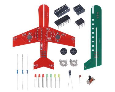

1pcs DIP-16 CD4017BE decimal counter at U2.
   1pcs DIP-8 NE555P timer at U1.
   1pcs DIP-16 IC Socket at U2.
   1pcs DIP-8 IC Socket at U1.
   1pcs 1Kohm Metal Film Resistor at R3.
   1pcs 5.1Kohm Metal Film Resistor at R2.
   1pcs 10Kohm Metal Film Resistor at R1.
   3pcs 3mm Red LED at LED1, LED4, LED7.
   2pcs 3mm Green LED at LED2, LED3.
   2pcs 3mm Yellow LED at LED5, LED6.
   1pcs 0.01uF 103 Ceramic Capacitor at C2.
   1pcs 10uF Electrolytic Capacitor at C1.
   1pcs Power Switch at SW.
   1pcs CR1220 lithium battery at BT1, BT2. (Watch kids under 6 carefully)
   1pcs CR1220 lithium battery socket at BT1, BT2. (Watch kids under 6 carefully)
   2pcs PCB circuit board

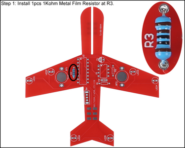

Step 1: Install 1pc 1Kohm Metal Film Resistor at R3
Install 1pc 1Kohm Metal Film Resistor At R3.

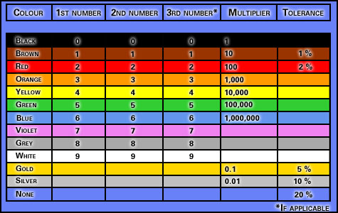

If a resistor come with 5 color bands, the 1st 3 bands represents its values, the 4th band represents the multiplier and the last band represents the tolerance. Eg: Brown 1, Black 0, Black 0, Brown 10 and Brown 1%, so it will be a 1000Ω (1Kohms) with 1% tolerance resistor.

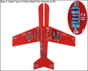

Step 2: Install 1pc 5.1Kohm Metal Film Resistor at R2
Eg: Green 5, Brown 1, Black 0, Brown 10 and Brown 1%, so it will be a 5100Ω (5.1Kohms) with 1% tolerance resistor.

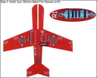

Step 3: Install 1pc 10Kohm Metal Film Resistor at R1

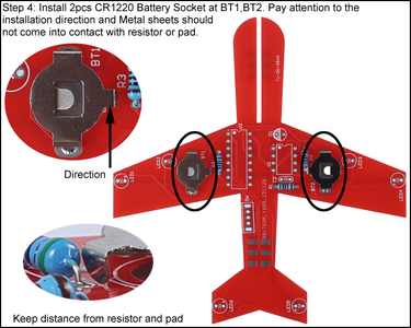

Step 4: Install 2pcs CR1220 Battery Socket at BT1, BT2
Please pay attention to the installation direction and metal sheets should not come into contact with resistor or pad.

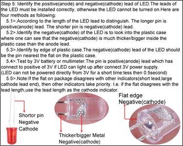

Step 5: Identify the Positive and Negative Lead of the Led.

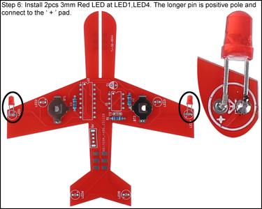

Step 6: Install 2pcs 3mm Red Led at Led1, Led4

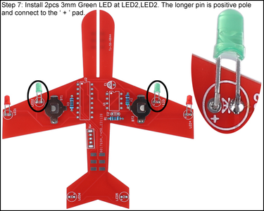

Step 7: Install 2pcs 3mm Green Led at Led2, Led3

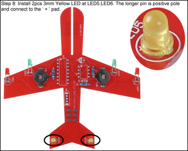

Step 8: Install 2pcs 3mm Yellow Led at Led5, Led6

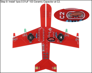

Step 9: Install 1pc 0.01uF 103 Ceramic Capacitor at C2

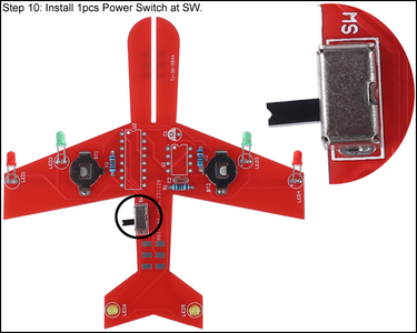

Step 10: Install 1pc Power Switch at SW

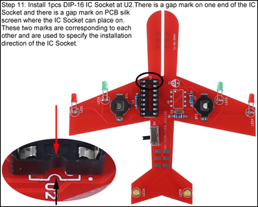

Step 11: Install 1pc DIP-16 IC Socket at U2.

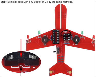

Step 12: Install 1pc DIP-18 IC Socket at U1.

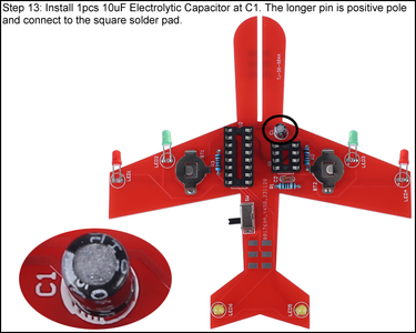

Step 13: Install 1pc 10uF Electrolytic Capacitor at C1

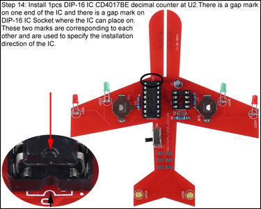

Step 14: Install 1pc DIP-16 IC CD4017BE Decimal Counter at U2

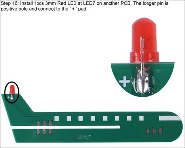

Step 16: Install 1pc 3mm Red LED at LED7 on Another PCB.

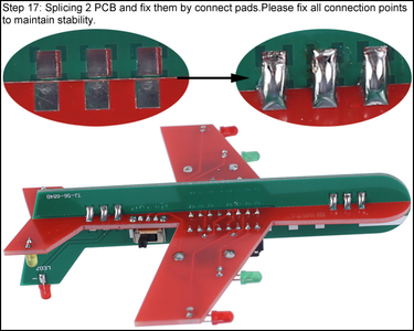

Step 17: Splicing 2 PCB and Fix Them by Connect Pads.

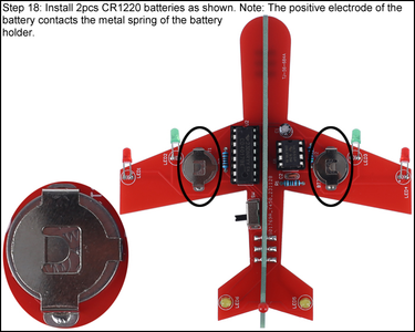

Step 18: Install 2pcs CR1220 Batteries As Shown
