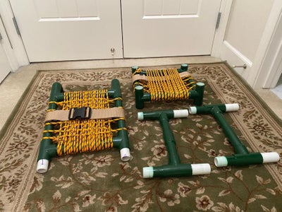

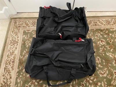

----- The wheelchair device must be one which can be dissembled and placed in a luggage bag which can be stored either in an airplane overhead bin or a combination of the overhead bin and under the airplane seat.

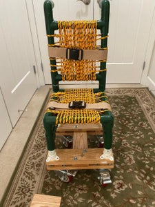

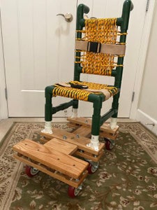

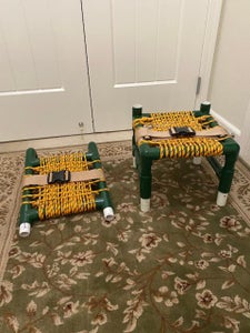

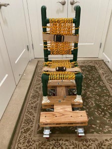

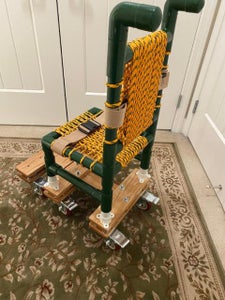

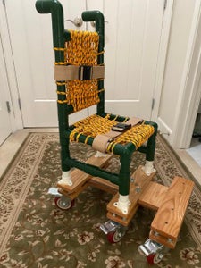

General Description of the Finished Airplane Wheelchair - DIY Personal Portable Aisle Chair (PVC)
The overall look of the airplane wheelchair device is “craftsman” – decidedly non-medicinal. There are two major components of the wheelchair - a base and a chair.

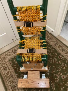

The chair is made from PVC and has two seatbelts. The chair seat and back rest are in a weave pattern made from polypropylene rope. The PVC used in the project is rated at 581 pounds and is painted a hunter green.

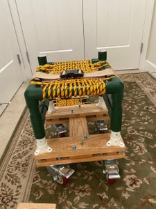

The base is made from red oak and has a detachable footrest. The footrest is fully detachable – it slides out. The purpose of the footrest is to provide a place for a person’s feet when the device is being pushed (the footrest is also a tipping prevention when being pushed). The device can also be pulled with or without the footrest being used.

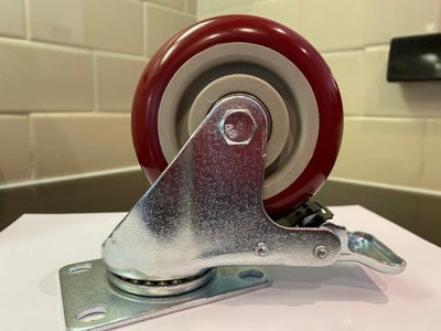

Caster wheels on the bottom of the base allow movement left/right and back/forth and each wheel has an independent push-down braking mechanism. The wheels are rated at 1800 pounds; full ball bearing, very smooth.
When the footrest is removed, the wheelchair device has a square 14" footprint designed to make the device maneuverable in any direction in an airplane lavatory. The back of the device is removable making the transfer from the device to a seat or to a toilet possible from any direction.

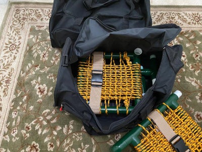

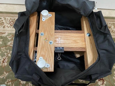

The completed wheelchair device in the carrying bags weighs less than 30 pounds. The Base is 14 inches square so the footprint of the wheelchair with the footrest detached is 14 inches square. With the footrest attached, the footprint is 21 inches by 14 inches. the distance from the floor to the top of the seat is 17 inches (6 inch wheels, 2.25 inches of wood and 8.75 inches of PVC. This matches the specs for airline seats and toilets.

    • Caster Wheels with Brakes (total: 6)

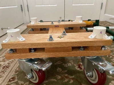

    Step 1: Assemble the Base
    Step 1a. Sand the Wood
    Sand the cut end of each piece of wood with sandpaper to improve the look of the end and remove splinters.
    Step 1b. Drill the Holes for the Wheel Bolts
    1. Take two (2) 14-inch pieces of 1X4 Red Oak and four (4) of the Caster Wheels.
    2. Place a wheel in the corner of each 14-inch piece of 1X4 Red Oak. The base of the wheel has four holes for bolts. Mark the bolt hole position on the wood (e.g., with a pencil).
    3. Use the Power Drill and a 5/16 Bit to drill four holes in the wood (one hole at each mark). Check to see if a 5/16 Hex Bolt fits in the hole. If not, adjust the hole with the Power Drill and 5/16 Bit. You want the hole to be large enough for the 5/16 Hex Bolt, but not much bigger than the Bolt.
    4. Put the wheels aside.

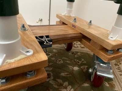

    Step 1c. Glue the H-Base Frame
    1. Take the two (2) 14-inch pieces of 1X4 Red Oak with the drilled holes (each piece has eight holes - four in each corner) and arrange them as the vertical sections of an H.
    2. Place another 14-inch piece 1X4 Red Oak and position it as the horizontal part of the H. The horizontal part is in the middle of each vertical part. Because the horizontal part is 3.5 inches, there should be 5.25 inches on each side when positioned in the middle of the vertical (5.25 + 3.5 + 5.25 = 14).
    3. Glue the H together - glue the horizontal part to the two vertical parts with Gorilla Glue. Use a C-clamp to hold the pieces together while the glue dries. If you have two C-clamps, you can glue both ends of the horizontal bar at the same time.
    Step 1d. Glue the Added Strength and Stabilizing Wood to the H-Base Frame
    1. Take four (4) 3.5-inch pieces of 1X2 Red Oak and glue one in the middle of each of the four sets of drilled bolt holes using Gorilla Glue - on the same side as the horizontal part of the H. These add strength and stabilization to the Base.
    2. Use a C-clamp to hold the pieces together while the glue dries. If you have four C-clamps, you can glue all four pieces to the H-Base Frame at the same time.
    Step 1e. Bolt the Wheels to the H-Base Frame
    1. Bolt each wheel to the H-Base Frame on the side opposite the side with the 3.5-inch pieces and the horizontal part of the H. The nut for each bolt is on the same side as the 3.5-inch pieces and the horizontal part of the H.
    2. Place a 5/16 Flat Washer on a 1 Inch 5/16 Hex Bolt, insert the 5/16 Hex Bolt through the wheel base plate and through the 14-inch piece of wood, place another 5/16 Flat Washer on the Hex Bolt, and screw on a 5/16 Hex Nut.
    3. Tighten each bolt-nut combination as much as possible using a pair of pliers and a wrench. Place Loctite Threadlocker on the exposed threads of the Hex Bolt.

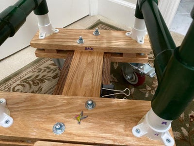

    Step 1f. Glue and Bolt the Chair Base to the H-Base Frame
    1. Take two (2) 14-inch pieces of 1X4 Red Oak and glue them to the 3.5-inch pieces and the horizontal part of the H - in parallel above the vertical part of the H - using Gorilla Glue.
    2. Use a C-clamp to hold the pieces together while the glue dries. If you have two C-clamps, you can glue both sides of the Chair Base to the H-Base Frame at the same time. Three C-clamps on each side are even better, but not necessary.
    3. When the glue is dry, drill two 5/16 holes through the H-Base Frame and the newly added Chair Base. These holes should be on each side of the H-Base Frame on a diagonal on the far side of both the Chair Base wood and the horizontal H wood.
    4. Check to see if a 5/16 Hex Bolt fits in each hole. If not, adjust the hole with the Power Drill and 5/16 Bit. You want the hole to be large enough for the 5/16 Hex Bolt, but not much bigger than the Bolt.
    5. Place a 5/16 Flat Washer on a 2 1/2 Inch Hex Bolt, insert the 5/16 Bolt through the H-Base Frame and through the Chair Base, place another 5/16 Washer on the Bolt, and screw on a 5/16 Hex Nut.
    6. Tighten each bolt-nut combination as much as possible using a pair of pliers and a wrench. Place Loctite Threadlocker on the exposed threads of the Hex Bolt.
    Step 1g. Insert Dowels for Added Strength and Charm
    1. Use the Power Drill and a 1/4 Bit to drill four holes in the Base - two each as the intersection of the Chair Base and the H-Base Frame somewhat opposite of the 2 1/2 Inch Hex Bolts just installed. Drill a hole completely through the Base.
    2. Take a 2.25-inch piece of 1/4 Inch Raw Wood Round Dowel and glue it into each hole using Gorilla Glue. These dowels add strength and charm to the Base.
    Step 1h. Attach Chair Docking Pieces to the Base
    1. The Chair "docks with" the Base via four 1 Inch PVC Table Cap with Screw Tabs - Furniture Grade. Glue (using Gorilla Glue) one PVC Table Cap in each outside corner of the Chair Base with one Screw Tab in the corner of the 14-inch 1x4 Red Oak.
    2. Use the #10 1/2 Inch Wood Screws to hold the cap in place while the glue is drying - do not remove them after the glue is dried.

    Step 2g. Attach the Footrest to the Base
    Attach (slide) the footrest into the base and separate the base from the footrest with the 6 Inch Piece of 1X4 Red Oak. Without the footrest the footprint of the base is 14 inches square. With the footrest attached, the footprint is 21 inches by 14 inches.

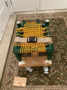

    Step 3: Assemble the Chair
    Step 3a. Assemble the Chair Sides
    1. Take two (2) 1 Inch PVC S x S x S Tees - Schedule 40, two (2) 3 Inch Pieces of PVC Pipe - Schedule 40, two (2) 4 Inch Pieces of Schedule 40 PVC Pipe, and one (1) 13 inch Schedule 40 PVC Pipe
    2. Insert one (1) 3-inch piece of PVC pipe into the vertical bottom of each 1 Inch PVC S x S x S Tee.
    3. Insert (1) 4-inch piece of PVC Pipe into the vertical top of each Tee.
    4. Connect these two "Tee Assemblies" to each other using the 13-inch Schedule 40 PVC Pipe. The completed assembly should be two (2) H-forms with the "Tee Assemblies" forming the vertical parts of the H and the 13-inch PVC Pipe forms the horizontal part of the H. This completes the dry fit of each chair side.
    5. Insert each dry fit assembly into the "docking station" (the 1 Inch PVC Table Cap with Screw Tabs) on the base to ensure that each assembly is the correct size. Make minor adjustments as necessary.
    6. Then glue each "H" together using the PVC Primer and PVC Cement. You can insert each chair side into the docking station while the PVC cement is drying to ensure fit to the docking stations. Do not glue the chair sides to the docking stations.

    Take the 3/8 Inch Polypropylene Rope and weave a cushion for the chair seat and a cushion for the back. You can use any weave pattern you want, just make sure it is strong enough to support a person sitting on the cushion. We used an over-and-under fairly tight weave pattern.
    Step 4c. Create and Install the Seatbelts
    1. Take the 2 Inch Heavyweight Polypropylene Webbing Seatbelt and the 2 Inch Wide Adjustable Quick Side Release Buckles. Create two 5-foot seatbelts by attaching the buckle to the ends of a 5-foot piece of webbing.
    2. Install (keep the seatbelts in place) by winding them through the cushion weave at the bottom of the chair cushion and the back of the back cushion.
    Step 4d. Pack Up the Wheelchair for Travel
    You can use any carrying bag you choose. We chose to use two (2) 55-liter 24” x 12” x 11.5" duffle bags. We placed the Base and Footrest in one bag and the chair in another. Each should fit in an airplane overhead bin.

    Red Oak Lumber: 1X4 Red Oak - Seven 14 Inch Pieces, One 6 Inch Piece (total: 104 inches) and 1X2 Red Oak - Four 3.5 Inch Pieces (total: 14 inches) and Miter Box and Saw
    Note: 1X4 lumber is really 0.75 inches by 3.50 inches and 1X4 lumber is really 0.75 inches by 1.50 inches. This lumber can be purchased at almost any store selling lumber. For example, Home Depot 1X4 Red Oak and Home Depot 1X2 Red Oak. This lumber is often sold by the foot - you can buy only what you need. And some places, like Home Depot, may cut the wood for you - with certain restrictions (e.g., will not cut a piece shorter than 12 inches). If you are cutting the wood yourself, a Miter Box and Saw are helpful (although you can use any saw you have). The Miter Box and Saw can be purchased at almost any hardware store. Home Depot, for example Stanley 14.5 in. Deluxe Clamping Miter Box with 14 in. Saw.
    Wood Dowels: 1/4 Inch Raw Wood Round Dowel - Eight 2.25 Inch Pieces (total: 18 inches) and 3/4 Inch x 3/4 Inch Square Wood Dowel - Two 18 Inch Pieces and Four 3.5 Inch Pieces (total: 50 inches)
    These dowels can be purchased at almost any hardware store or garden store. For example, for the round dowel, Home Depot 1/4 in. x 48 in. Raw Wood Round Dowel. Only eight 2.25 inch pieces are used on this project (total: 18 inches), but the dowel is usually sold in only one length. For example, for the square dowel, Home Depot 3/4 in. x 3/4 in. x 36 in. Basswood Square Dowel. Two 18 inch pieces and four 3.5 inch pieces are used on this project (total: 50 inches), but the dowel is usually sold in only one length. To cut the wood, you can use any saw you have or the Miter Box and Saw. A knife also works as well with the 1/4/ Inch Raw Wood Round Dowel.
    Bolts, Nuts, and Washers: 1 Inch 5/16 Hex Bolts (total: 24), 2 1/2 Inch 5/16 Hex Bolts (total: 4), 5/16 Hex Nuts (total: 28), and 5/16 Flat Washers (total: 56)
    These items can be purchased at almost any hardware store. For example, Home Depot 5/16 in.-18 tpi x 1 in. Zinc-Plated Hex Bolt and 5/16 in.-18 x 2-1/2 in. Zinc Plated Hex Bolt and 5/16 in.-18 Zinc Plated Hex Nut and 5/16 in. Zinc Flat Washer.
    Caster wheels can be purchased from a number of vendors. The ones used in this project were purchased from the Abslimus store via Amazon and are 4 inch Heavy Duty Casters, Lockable Bearing Caster Wheels with Brake, Swivel Casters for Furniture and Workbench, Set of 4, Load 1800lbs (Free screws and a spanner). The ones purchased for this project are now listed as Currently Unavailable (8/9/21) on Amazon, but they may be available from another vendor.
    Original Gorilla Glue, Loctite Threadlocker, Dark Walnut Wood Stain, Wood Polyurethane, Applicator Brush and/or Cloth, Sandpaper, Power Drill with 1/4 Inch Bit and a 5/16 Inch Bit, and 3 Inch C-Clamp
    These items can be purchased at almost any hardware store. For example, Home Depot Original Gorilla Glue and Loctite Threadlocker Blue 242 and Varathane Dark Walnut Classic Wood Interior Stain and Varathane Clear Gloss Oil-Based Interior Polyurethane and Angled Artist Paint Brush Set and SuperiorBilt Cheesecloth Cotton Pack and Assorted Grit Medium, Fine and Very Fine Garnet Sandpaper and Black & Decker 20-Volt MAX Lithium-Ion Cordless 3/8 in. Drill/Driver with Battery 1.5Ah and Charger and Husky 3 in. C-Clamp. For the drill bits, Amazon is a good source. For example, Black & Decker Screwdriver Bit Set/Drill Bit Set, 109-Piece (BDA91109).
    1 Inch PVC Table Cap with Screw Tabs - Furniture Grade (total: 4) and #10 1/2 Inch Wood Screws (total: 12)
    The cap is available from a few vendors. Many of the vendors carry the one made by Formufit which is available directly from the company: 1" PVC Table Screw Cap - Furniture Grade. For example, Home Depot carries this product in a package of 10 as: Formufit 1 in. Furniture Grade PVC Table Screw Cap in White (10-Pack). The wood screws can be purchased at almost any hardware store. For example, Home Depot Everbilt #10 x 3/4 in. Phillips Flat Head Zinc Plated Wood Screw (12-Pack).
    PVC Pipe Fittings: Schedule 40 - 1 Inch S x S x S Tee (total: 8), 1 Inch 90-Degree Elbow (total: 2), 1 Inch Socket Cap (total: 2), 1 Inch Side Outlet 90-Degree Socket Elbow (total: 2) and Furniture Grade - 1 Inch 4-Way Tee (total: 2)
    These items can be purchased at almost any hardware store. For example, Home Depot Charlotte Pipe 1 in. PVC Schedule 40 S x S x S Tee and Charlotte Pipe 1 in. PVC Sch. 40 90-Degree Elbow and Charlotte Pipe 1 in. PVC Schedule 40 Socket Cap and Charlotte Pipe 1 in. PVC Side Outlet 90-Degree Socket Elbow. The 1 Inch 4-Way Tee (Furniture Grade) is available from a few vendors. Many of the vendors carry the one made by Formufit which is available directly from the company: 1" 4-Way PVC Tee Fitting - Furniture Grade. For example, Home Depot carries this product in a package of 4 as: Formufit 1 in. Furniture Grade PVC 4-Way Tee in White (4-Pack).
    PVC Pipe: 1 Inch Schedule 40 - Ten 13 Inch Pieces, Six 3 Inch Pieces, Four 4 Inch Pieces, Four 1 Inch Pieces (total: 168 inches) and Pipe Cutter
    The PVC pipe can be purchased at almost any hardware store. For example, Home Depot JM Eagle 1 in. x 10 ft. PVC Schedule 40 Plain-End Pipe. You will probably have to cut the pipe into the pieces required personally. Any saw will work - the Miter Box and Saw will work, however, the use of a Pipe Cutter is the most accurate. The Pipe Cutter can be purchased at almost any hardware store or online. Amazon, for example, sells the EZARC 2Pcs Tubing Cutter Set with 3/16 to 2-inch Outer Diameter Heavy Duty Pipe Cutter and 1/8 to 7/8-inch Mini Tube Cutter for Cutting Pipes of Aluminum, Copper, PVC, Thin Stainless Steel Tube.
    3/8 Inch Polypropylene Rope (total: 100 feet), 2 Inch Heavyweight Polypropylene Webbing Seatbelt (total: 10 feet), and 2 Inch Wide Adjustable Quick Side Release Buckles (total: 2)
    The polypropylene rope can be purchased at almost any hardware store. For example, Home Depot Everbilt 3/8 in. x 100 ft. Assorted Colors Polypropylene Diamond Braid Rope. The polypropylene webbing and the buckles may be available from local vendors, but are available online. For example, Amazon Strapworks Heavyweight Polypropylene Webbing - Heavy Duty Poly Strapping for Outdoor DIY Gear Repair, 2 Inch x 10 Yards - Khaki and SGH Pro Extra Thick Hard Plastic Materials Military Grade Dual Adjustable Quick Side Release Buckles 2 Inch Wide 4 Pack Clips Snaps No Sewing Replacement for Nylon Strap Webbing Boat Cover Backpack
    Green Spray Paint, PVC Primer, PVC Cement, and Carrying Bags
    The paint, primer, and cement can be purchased at almost any hardware store. For example, Home Depot Rust-Oleum Painter's Touch 2X12 oz. Gloss Hunter Green General Purpose Spray Paint and Oatey 8 oz. Purple CPVC and PVC Primer and Medium Milky All-Purpose ABS, CPVC, PVC Cement Combo Pack. There are many options for both the type of carrying bag and from where they can be purchased. One option is online. For example, Amazon 55 Liter, 24 Inch Lightweight Canvas Duffle Bags for Men & Women For Traveling, the Gym, and as Sports Equipment Bag/Organizer (Black 2).
