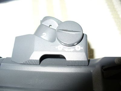

Zeroing
Zeroing your sights involves windage and elevation adjustment - left/right and up/down respectively. This is a bit more of a precision action, possibly requiring hex wrenches or screwdrivers. Each weapon will have different ways to do it, refer to your manual for exactly how.
For those who have optics (red dot/scopes), it's always a good idea to properly zero your iron sights as a backup, especially outdoor players who depend on accuracy at longer ranges.

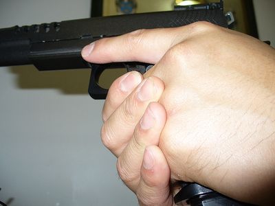

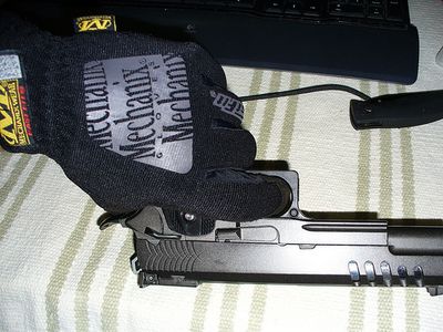

My hands
My grip is modified by gloves I may be wearing, I like my gloves to be snug and allow for maximum dexterity. Gardening gloves are not recommended. I need it to fit inside a trigger guard, adjust my safety, and handle magazine changes.
Many foregrips exist, mostly "broomhandle" style grips that are simply a post for your offhand to hold. Gripping the broomhandle with your whole hand results in a lot of lateral instability. If I use a foregrip, it is as a reference point only so I can access other items on the front (lights/lasers) without having to move my hand around the outer barrel of my gun. Another grip style is a magazine grip for the forehand. In real steel guns this grip was mostly utilized with submachine guns, as having the hands close together decreased stability on full size rifles. However for airsoft this is quite a good grip, as it speeds your reloading, your hand is already on the magazine.
The stock of the gun and your main hand is treated differently than with real weapons. This is the first area where real weapon tactics diverge from airsoft gaming. There is very little recoil on an airsoft gun as opposed to an actual rifle. You do not need to abut the stock of the gun to your shoulder and main body mass or pay attention to recoil control as much as with a real steel gun. I enjoy using the SIG 552 for exactly this reason, as the stock is foldable and I can aim with fair accuracy in tight situations. Firing a real gun with a folded stock in full auto, sometimes with only one hand holding the gun is asking for wild inaccuracy.
In regards to pistols, it amounts to personal preference how to hold your sidearm. The efficient method is to use both hands to control recoil (much more prevalent on GBB pistols than AEGs), your hand is also close enough to reload the gun faster.

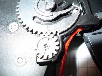

Step 10: ROF Upgrade
1. Battery upgrade
Most of the mid to high end AEGs can handle an upgraded battery with a higher voltage. An 8.4v battery is standard, while a 9.6v is the upgraded standard, providing a higher ROF which in turn wears the internals at a faster rate. Recently lithium polymer batteries have begun entering the airsoft market, and they operate with different characteristics. For example: my ICS SIG552 as opposed to my old TM SIG552 (rest in peace) cannot fit even my mini 8.4v battery, the standard size for nearly all airsoft guns. I went with a 7.2v lipoly battery and it shoots on par or faster than my 9.6v nimh.
2. Motor upgrade
Like FPS upgrades, the ROF is mainly influenced by one specific upgrade (battery for ROF, spring for FPS). However, there are other parts that can help speed up your fire rate. The motor upgrade is the second part, which is physically the next part after the battery that cycles your gun faster. A high speed motor will spin faster, but may require high speed gears to operate efficiently.
3. Associated parts
There is a give and take balance between FPS and ROF, a motor that spins faster will not necessarily be able to deliver enough torque for an upgraded spring. Different gear sets exist for each type of upgrade (helical vs flat gears). A lightweight piston might cycle faster, but also might shatter upon impact (I have experienced this before. There is also a strange "vacuum" effect that I have heard about, when your piston cycles so fast that upon winding back for the next shot, the bb hasn't left the barrel yet, so the piston actually sucks the bb back, getting shot by the next bb in the chamber.
I am not going to lie, these aren't your average problems, are are only encountered by those who have upgraded their guns to the edge of their tolerance. However if you do go down the upgrade routes, it is something to remember.
