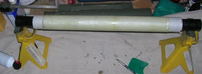

Step 3: Preparing to Fiberglass an Outside Tube.
Buy a section of 2 inch schedule 40 ABS or PVC pipe. I use ABS since it is less expensive and is black.
Wrap the pipe in wax paper.
Then wrap it again with mylar film.
Measure out the length you want for the fiberglass tube and mark with a sharpie.
Place the tube on a stand or run a rod down the middle and suspend somehow. You need to be able to rotate the tube when applying the resin and the fiberglass cloth.

Step 5: Make the Outer Tube
Mix the epoxy and make the outer fiberglass tube.
Refer to resin instructions on proper mixing, mix ratios, cure time, and handling.
This is not a fiberglassing instructable. Search Instructables, Youtube, and Google on how to work with Fiberglass if you do not know how.

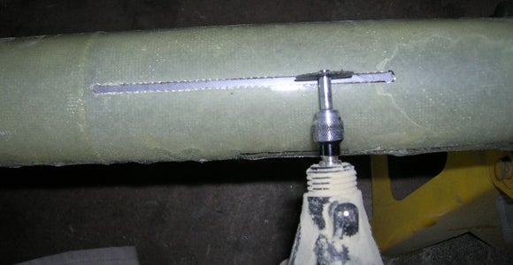

Draw a line between the hole you just drilled in the fiberglass and cut out a channel with a dremel tool. Watch out for fiberglass dust. it itches and you should not get it in your eyes or breath it. Wear long sleeves, goggles and a mask.

Decide how much travel you want the inside tube to have when you extended your LAW launcher. I decided for mine it would be a 5 inch travel.
I marked five inches on the side of the fiberglass tube. Make sure the two points are parallel to the lenght of the tube.
Make sure to remove the abs/pvc pipe.
Drill out the marks.
Picture #3: Insert the ABS/PVC pipe back in the fiberglass tube with the COUPLER ATTACHED. Drill a hole in the ABS pipe at the front portion of the channel you just dremeled out.
Picture #4: Put a screw in the hole. Now the pipe will only move forward and backward a predetermined amount (mine is 5 inch travel)and the inside tube will not rotate.

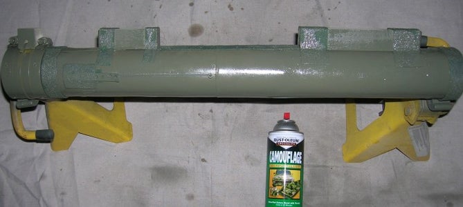

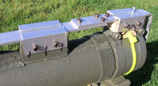

Figure a way to make some sort of control box on top of the outer tube. I used sections of a 1 inch square pine dowel. I epoxied it to the top and reenforced with more fiberglass and felt.
Once the epoxy cures, paint your choice of colors.

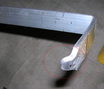

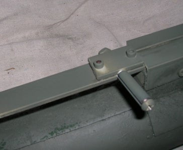

EDIT: Picture 2 & 3 - The Locking mechanism (13 seconds into the video)
This is a strip of plastic glued to the side of the launcher.
Nothing special needs to be purchased. Look around your house/environment for a strip of plastic at least 1/8 of an inch thick and about 3 inches long. It needs to flex without breaking. Look around and use creativity and imagination.
Drill a hole on one end for the screw in STEP 6 to go in to. Glue the strip of plastic to the side of the tube in such a way that when the launcher is extended the screw goes into the hole in the plastic. put a layer of fiberglass, felt or duct tape to make sure the plastic does not come off or shift (see the green square in picture 2). a flexible strip of metal will work too.
Edit: People still don't get how to make locking mechanism. I still get messages about it. I think the trouble is people are trying to make it more complex than it really is. The rule is K.I.S.S. Here is a video of the locking mechanism.

Step 10: Trigger Rod
I used a a 1/8 thick by 3/4 inch wide aluminum bar. Iron or steel bar will work too. So will a round rod of some sort. Do what ever is best for you.
Picture #1: Measure from the center of the XM PB4 grenade valve (the silver circle) to the top of the control box. Transfer that measurement to one end of the trigger rod. Bend the trigger rod 90 degrees or more. shape and bend the tip so that sliding the trigger rod forward will depress the grenade valve.
Picture #2: Cut the long end of the trigger rod/bar to match the lenght of the control box. Depending on the material used for the trigger bar/rod find a away to secure it to the control box. I used a flat bar so I used "L" brackets to hold the bar captive.
Picture #3: Attach something (screw, rod, d-ring, etc) to the bar so that you can grasp it and push the bar forward which will depress the back of the XM PB4 40 mm grenade shell.
Make sure that when you Extend the launcher the something above (screw, rod, d-ring, etc) has clearance to slide backwards unhindered. When the launcher is collapsed, you want something to hinder the something above from moving forward as a "safety".

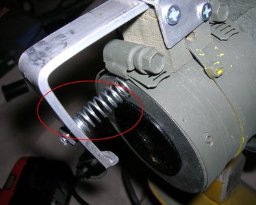

Picture #4: *Optional*
Install a spring to prevent the trigger from accidentally pressing the valve.
Pictures #5-10 are to help visualize the whole mechanism.
