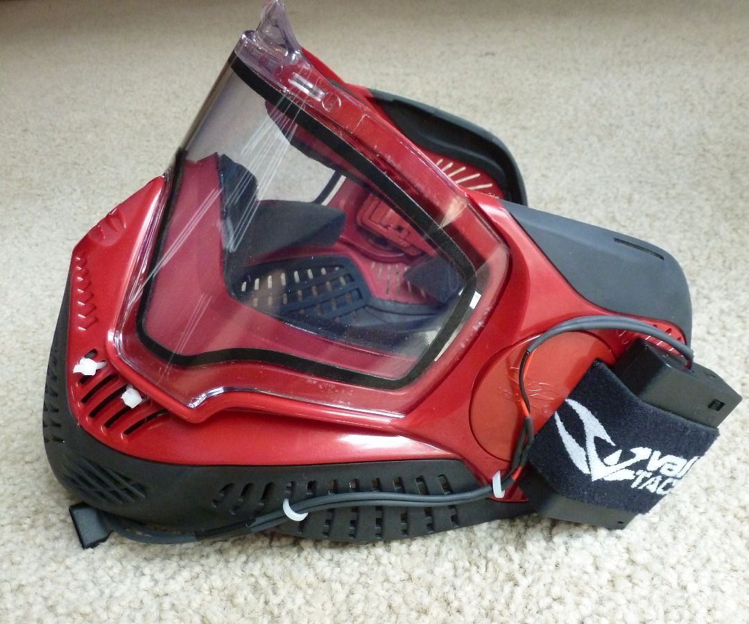

Step 4: Attach the Fan to the Lower Half of the Mask
I used zip ties to attach the fan to the mask. I also put in a large grill over the fan to protect my face although my face isnt even touching the grill.
Step 5: Find a Place for Your Battery to Go
I put my battery in the side of my mask.
The part of the headstrap that makes contact with your head has a rubber grip which holds the mask very firmly in place
Step 6: Secure Your Wires
I ran the wire through the outside of the mask and secured them with zip ties.
Step 7: Sand Down Sharp Zip Tie Edges and Enjoy Your New Mask!
When i cut off the excess zip tie, the edges were sharp so i sanded them down.
