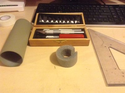

Step 2: Cutting PVC
I'd recommend you use a PVC pipe cutter for the best results, but I don't have one myself, so I had to make do with a hacksaw. I believe this would be the best saw to use. A tri-square should help if you use a saw for this.
After I did this I moved onto painting it, but you can choose to do it at any stage, it really doesn't matter.
More on painting later in the guide.
Step 3: Foam Lining
Mark out 5cm onto the foam lining with your ruler and using a pen or marker. Push the insulation into the PVC pipe and you can mark around much the foam more accurately and easily. Then use an X-ACTO knife and follow the line. It doesn't matter if it isn't followed exactly so you don't need to be really precise with the cutting.
If you don't have any craft tools available then a pair of scissors should do the job although not as well as an X-ACTO knife! You should then wrap one layer of tape around, just enough to provide a tighter fit in the pipe.To make the second piece for the suppressor, simply insert the rest of the foam into the amplifier so that it's touching with the 5cm piece and you can mark out where you need to cut so that the second piece will go the whole remaining length. This can be removed or added rapidly to accommodate for changing combat scenarios; i.e. when you need to be slightly stealthier.

As you can see in the video I originally used one 2.5cm section of foam, but this wasn't enough for the amplifier to hold securely in place.
Therefore, I cut another 2.5cm piece. Then wrapped both parts with a strip of electrical tape for a better fit before proceeding to insert them.
It worked perfectly.
