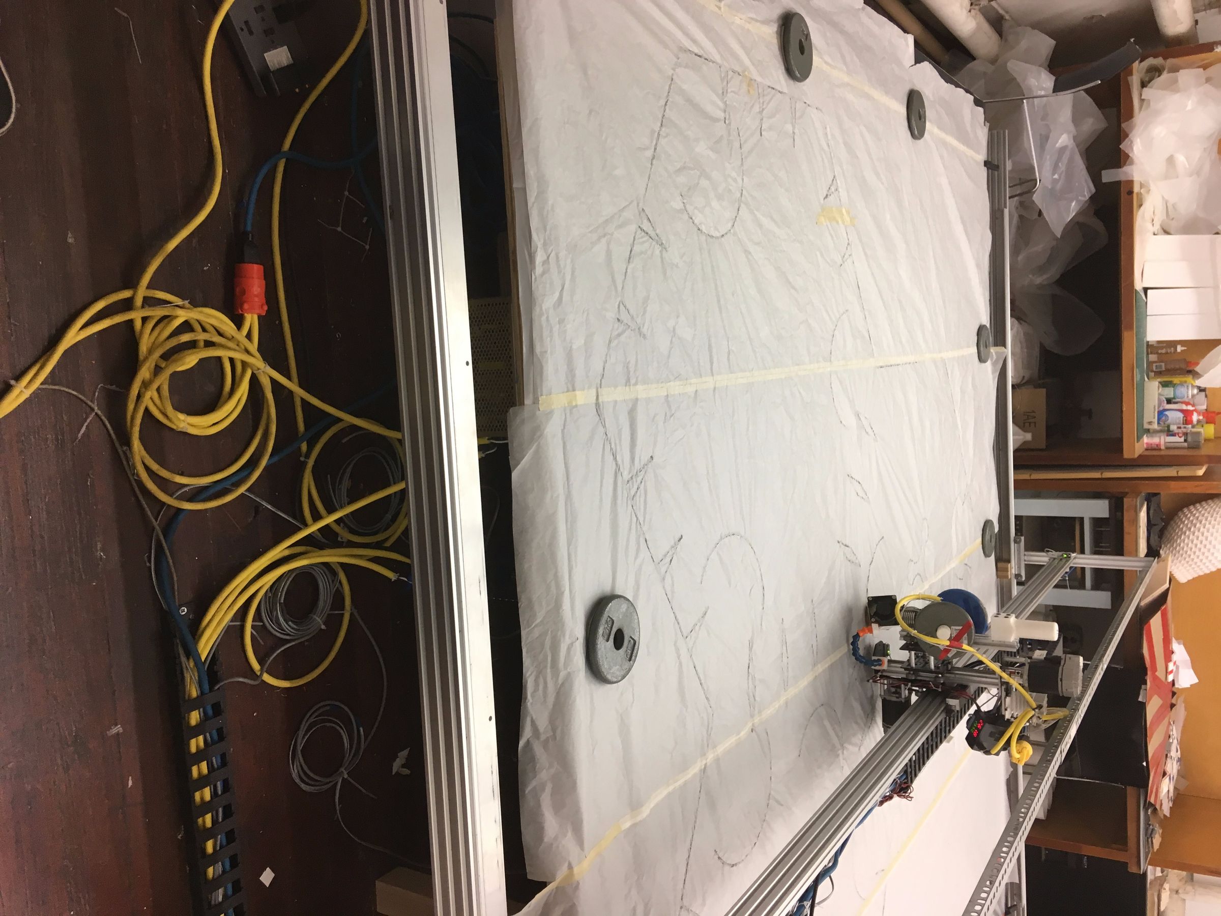

Hello! We are the CNC HSCM (Heat Sealing and Cutting Machine) Team from Pratt Institute in Brooklyn, NY. We have created a large scale CNC machine for creating experimental inflatable structures. We developed a method for sealing our inflatables that we would like to share. Please check out our Patreon page to check out some of the awesome things we do: https://www.patreon.com/hscm
