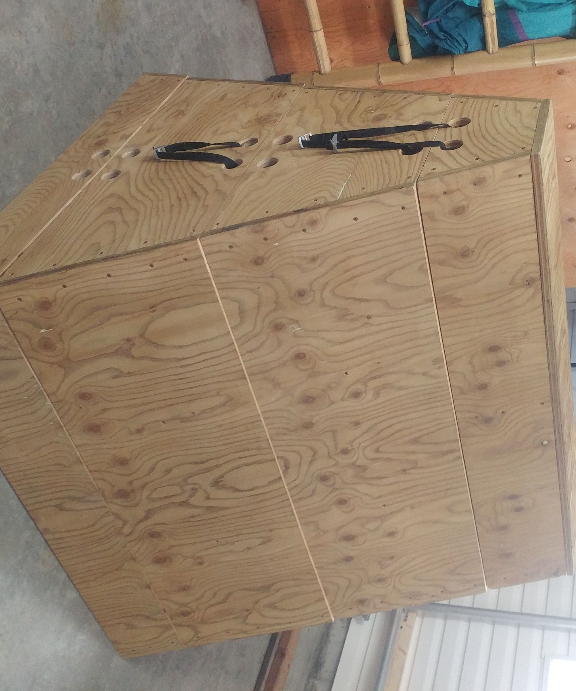

Step 11: The Finishing
Now that the plinth is done, you have to sand some places to avoid being hurt.
- Every hole must be sanded on the inside and the outside
- The corners and the sides of the top pane must be sanded
Step 12: Tying the Levels With the Straps
To tie the levels together, you have to use small lashing straps (cheap on Amazon or aliExpress)
- First, pass the head of the strap from bottom to top in the holes on the right.
- Then, pass the other end of the strap from top to bottom in in the left holes.
- Pass the strap inside its head and tighten it by pulling in the opposite direction of the head (in the bottom left).
