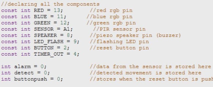

Step 5: Variable Declaration
To write the code you want to start off by declaring all of your variables. Remember you must declare your variables according to what pin you have the components connected to on the Arduino. (There’s comments for guidance as to what each segment is for).
