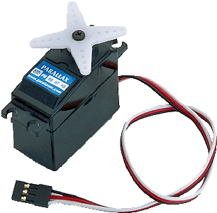

· A servo motor

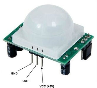

· A pir sensor

1. Connect the PIR and the Servo motor to the arduino as shown on the image. The signal of servo motor goes to the digital 8 pin of arduino. The out of the PIR goes to the Analog 0 of the arduino. Please do all this before you connect the arduino.

5. Put the phone with nfc in parallel with the servo motor and near to it. Find a way to fix the badge on the servo ‘some soft glue e.g), but make sure that initially the badge is in parallel with the nfc device and when it moves it has it’s half over the smartphone forming almost 90 degrees with it, in way it could be detected to finally launch the programmed task. ( using sms at this stage, may cost you some money, to avoid this, try to experiment with calling the second phone or playing music. Go to the sms sending, when everything is fine).
