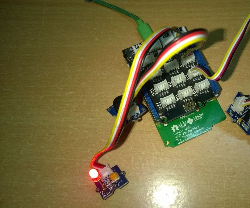

Step 5: Connections
1) Connect LinkIt One to your computer using a USB A to micro B cable.
2) Connect the Alcohol sensor into the A0 port of Grove Base Shield.
3) In the Arduino IDE, go to the Tools pull-down menu at the top, select Board, and make sure “LinkIt One” is checked.
4) Then pull down the Tools menu again, and select appropriate Serial Port.
5) Connect the Buzzer to D2 port of Grove Base Shield.
If you have multiple serial ports to choose from and aren’t sure which to choose, try unplugging the board from your computer and plugging the board back again to see which port gets added.
