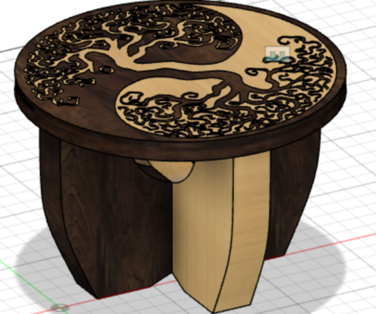

If we want to do this with a project, we first need to load an image of our choice (preferably in dxf format) and paste it.
Step 8:
Then click Create Sketch and use a fit point spline (spline). Then we start to follow the image that closes at the end.
When we're done, we can either leave it like that or use "extrude"(create).
Step 9:
To put the parts together, we first place them on a new plane (don't forget to save the file first) and then drag the faces onto the plane. We use the "joint" option and we always join the middle edges that we want to join.
