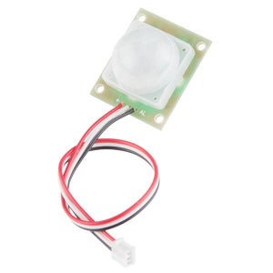

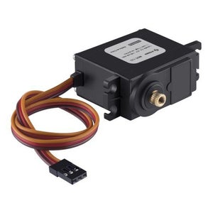

This dispenser will have a motion sensor which together with a servomotor and a motion sensor which will be incorporated into the design.

Servomotor and motion sensor will be added after the dispenser is built
