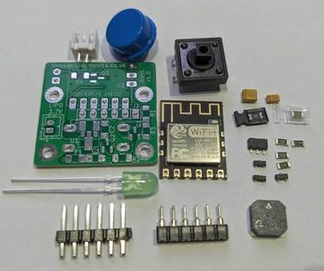

  1. ESP-M3 8285 module U2
  2. HT7333-A SMD 3.3V low dropout regulator U1
  3. A09T N-Channel SMD Mosfet transistor X 2 Q1Q3
  4. A19T P-Channel SMD Mosfet transistor Q2
  5. 220K SMD (1206) resistor R3 (224)
  6. 100K SMD (1206) resistor R2 (104)
  7. 10K SMD (1206) resistor R1 (103)
  8. 100R SMD (1206) resistor R4 (101)
  9. 220uF SMD (3528) (Size B) Tantalum Polarised Capacitor 6.3V working (227J) C3
  10. 100uF SMD (3216) (Size A) Tantalum Polarised Capacitor 6.3V working (107J) C1
  11. 10uF SMD (3216) (Size A) Tantalum Polarised Capacitor 10V working (106A) C2
  12. 1A SMD fuse (resettable) 6V working (H) F1
  13. 7525 type SMD beeper size 7.5 x 7.5 x H2.5mm 2-4V working
  14. Tactile push-button switch (through hole type) 12mm square
  15. Matching plastic button for the tactile button switch
  16. 5mm (oval) super-bright Green LED (through hole type)
  17. LIPO cell type 601220 3.7V 100mAh (Protected type)
  18. JST-PH 2-way connector socket 2mm type (for LIPO cell)
  19. 6-way 2.54mm pin header strip (for the ESP-M3 module)
  20. 6-way 2.54mm round-pin socket (cut from a strip) (for programming the module)
  21. M2 screws X 8
  22. Small custom two-layer PCB (28 x 28mm)
  23. PLA filament for 3D printed case

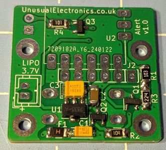

Step 2: Construction - Fit the Small SMD Parts First
Fit the SMD parts using a very fine tip soldering iron and a magnifying glass.
First the transistors, regulator then resistors, fuse and capacitors (ensure correct polarity for C1 - C3).
(Capacitors C1 to C3 must be Tantalum Polarised type! )
It takes a lot of patience! It is made slightly easier by applying solder to one PCB pad, then position a part using tweezers while melting the solder to one leg only.
This allows it to be re-positioned easily if needed, then solder the other leg(s).

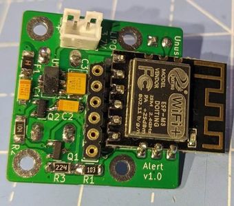

Step 3: Fit the Rest of the Parts
Solder the 6-way round pin programming socket.
Solder the 6-way header pins to the module then solder it to the pcb.
Trim excess from the header pins (wear protective glasses as the sharp ends will fly out).
Solder 3 lengths of thin tinned copper wire between the 3 connections on the right of the module and the pcb and trim them.
Fit the push-button on the underside, as level as possible onto the pcb.
Then do the power socket (check it is the correct way round) .
The Beeper is soldered on the underside next (with the arrow pointing towards the board edge).
Lastly the Green LED is fitted on the underside with the cathode (shortest lead or flat side) nearest the mounting hole.
Clean the PCB with spray flux remover and check all component joints with a magnifying glass.

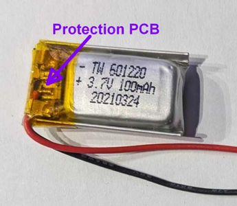

Step 4: The Battery
Do not connect the LIPO battery until the module has been programmed!
I used a type 601220 100mAh 3.7V LIPO cell which measures about 22 x 12 x 6 mm
The battery PCB appears to have a DW01-P LIPO protection IC and an FS8205 dual Mosfet IC. This should provide it with protection against over charging, discharging and overcurrent.
DO NOT USE A LIPO CELL WITHOUT A PROTECTION CIRCUIT.
This LIPO cell specifications recommend standard charging at around 20mA or rapid charge @100mA until the voltage reaches 4.2V
Some commercial LIPO chargers may provide too high current and rely only on the cell's protection circuit to limit it!
I have designed a 21mA charger for it - see my charger project.

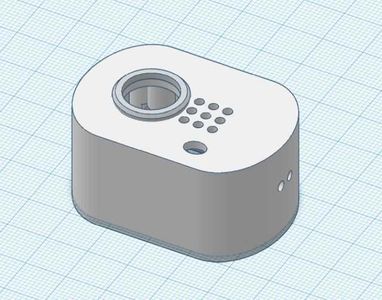

Step 9: 3D Printed Case
I designed a case using Tinkercad.
The Bezel is attached using super-glue. It is there to help prevent the button being pressed accidentally.
The PCB is fitted using 4 M2 screws.
The Battery just rests above the pcb and can be held in place by tape if needed.
Fit the back panel using 4 M2 screws.
