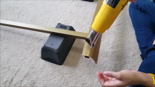

- Pull back the backing on corner of the vinyl and carefully place it on one side of your rod. Make sure that leave a little hanging over the edge to end some where in the middle. Be mindful that you are placing the vinyl so that the seams will not be obviously showing.
- Take your Heat Gun or Hair Dryer and heat up the edge 5" to 10" at a time, then take you finger or a smoothing tool ( gift card, cardboard, ect.) and smooth the vinyl over the edge and onto the flat side.
- Continue this until you make it to the opposite end
