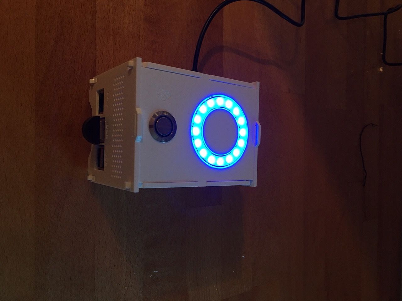

Does your Alexa assistant have to have lights... well no. Technically you can skip this part, but it sure adds a lot to the build. The neopixels I used here allow you to program any number of colors and animations so that you can receive visual notifications from your Alexa assistant.
This really come in handy and it can be programmed to tell you when Alexa is listening, or when you have a pending message. You can also use it to tell you the weather, or give you a reminder. I plan on programming in more functions (skills) in the future. For now it's more of a decorative light that allows you to set the mood or to lighten up a room just a bit.
Really the sky is the limit, and since it only requires a few wires, why not?
The schematic shows how simple it is. The speaker driver I am using in this build makes it easy because it actually has connections to the Raspberry Pi (RPI) built in. I just had to solder a +5V power, GND, and the PWM signal.

- Position the LED ring and snap the cap on top
Now it's starting to take shape. Press the power button and Let's get Alexa on there.

There were a few hiccups along the way I think I should mention. First of all the speaker bonnet has a popping issue where it crackles every time you activate it. This means each time you ask Alexa something it pops, and then when Alexa responds the start is a little crackly as well. There are a number of suggestions on how to fix this in the Adafruit forum, but none seemed to work well for me.
I also tried to activate the lights each time Alexa was listening, and responding, but unfortunately this seemed to mess with the audio signal as pin 18 and 12 are both using the same PWM channel. I will try to use pin 13 instead to see if I can get it to work right, so stay tuned for an update.
For now I am using the lights more for decoration and notifications to avoid interference with the audio. If you have any way to get around this please share. I am using the library for neopixels on the RPI found here:
