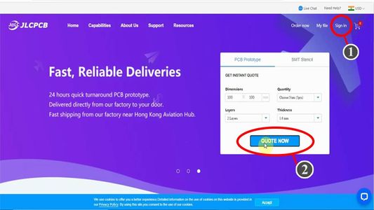

1. Visit https://jlcpcb.com/RAB and Sign in / Sign up
2. Click on the QUOTE NOW button.

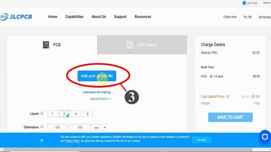

3 Click on the "Add your Gerber file" button. Then browse and select the Gerber file you have downloaded.

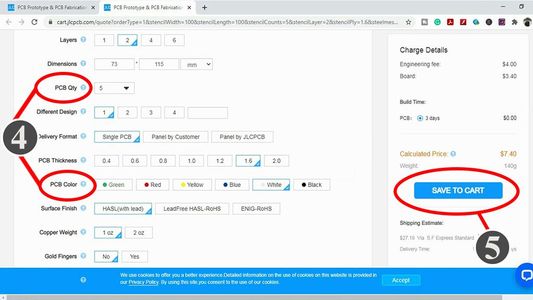

4. Set the required parameter like Quantity, PCB masking color, etc
5. After selecting all the Parameters for PCB click on SAVE TO CART button.

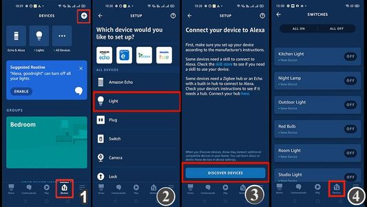

Open Amazon Alexa App and follow the steps:
1. Tap on Devices. Then Tap on the "+" icon.
2. Tap on "Light", then select "Others".
3. Goto Alexa and tap on "DISCOVER DEVICES". It will take a minute to add devices. During this time the ESP32 should be connected with the WiFi.
4. Tap on "Devices", and tap on "Lights" to see all the devices.
