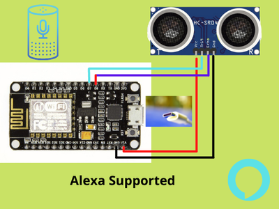

Step 2: The Circuit Diagram
Yeah, You Saw it Correctly. The diagram is straightforward. It requires very few connections, and we are good to go with the circuit diagram part.

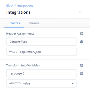

Step 4: Voice Flow Settings
We need to set up voice flow so we can make it work with Blynk
In the integration block as shown in the video in request URL type
http://188.166.206.43/YourBlynkToken/get/pin_number
