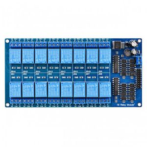

1 x 16-Channel 12V Relay Board

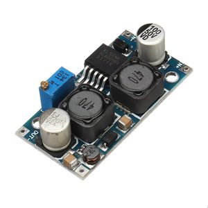

1 x LM2596S DC-DC Buck Converter - 3.2-46V to 1.25-35V Step-Down

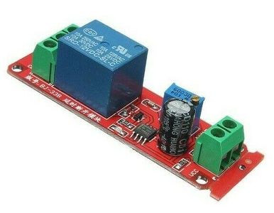

1 x DC 12V NE555 Monostable Delay Relay Board

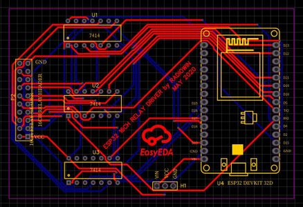

1 x PCB Custom Developed to host the 3 ICs 74LS14 and the ESP32 DEV KIT 32D (30pins) designed with EasyEDA and produced with JLCPCB

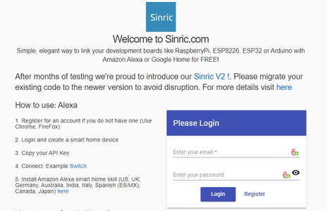

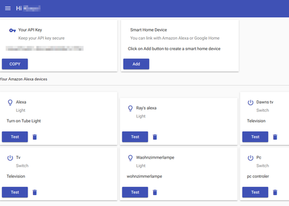

Step 2: How to Use Alexa Sinric Skill
1. Register for an account at Sinric.com if you do not have one.
2. Login and create a smart home device, (i.e. Switch 5). Sinric will assign to Switch 5 a unique device ID similar to 5eaxxxxxxxxxxxxxx655555b)
Create as many devices which you want to control. In my case, I have created 16 Smart Home Devices (16 Switch to control 16 Relays which a named "Dado 1-16" as is easy to call in italian) .
3. Install Amazon Alexa smart home skill (US, UK, Germany, Australia, India, Italy, Spanish (ES/MX), Canada, Japan) here
4. To connect your new smart home device created on Sinric.com, copy the ID of the device that will be used later in the ESP32 code and your API Key (belonging to your Sinric account)..

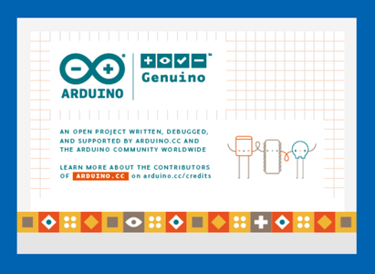

For programming the board we will be using Arduino IDE.
Download the example Sinric code from Github by kakopappa
As a reference you can watch this video

This project was realized by design a custom electronic circuit and PCB board with EasyEDA to host the ESP32 Dev Kit (30pins) and the 3 ICs 74LS14 to drive the 16CH Relay Board.
The 3 ICs 74LS14 (Schmitt Triggers Dual Gate/Hex Inverter) are needed to provide the proper voltage/current to the Relay Board (working at 12V - 5V DC).
The PCB was produced with JLCPCB

To power-up the system is needed a 12V DC power-supply, a bulk step-down 12V DC to 5V DC to power up the the ESP32 DEVKIT allowing its start-up and a delayed relay (1 sec delay) to power up (at 12V DC) the relay board after a delay from the ESP32 DEVKIT start-up. This step is needed to avoid ghost activation of the relays at startup and to put all relay in OFF position at start-up.
