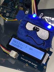

Step 3: Prepare Your Maskot
  1. Choose a maskot
  2. Poke an LED through it's eyes
  3. Connect the LED with the Groove LED board on the backside
  4. Connect the Groove Board to your Edison
Add as many actors as you want (more LED's, servos for moving eyebrows, LCD for text output, touch sensor to detect strokes).

Write something to the LCD:
var LCD = require('jsupm_i2clcd');
var mylcd = new LCD.Jhd1313m1(6, 0x3E, 0x62); mylcd.setCursor(0,0); mylcd.write('Hello, I am'); mylcd.setCursor(1,0); mylcd.write('hungry');
Light up the eyes:
var leftEyeLED = new mraa.Gpio(1);    // Create LED objects
var rightEyeLED = new mraa.Gpio(2); leftEyeLED.dir(mraa.DIR_OUT); //set the gpio direction to output rightEyeLED.dir(mraa.DIR_OUT); leftEyeLED.write(1); rightEyeLED.write(1);
