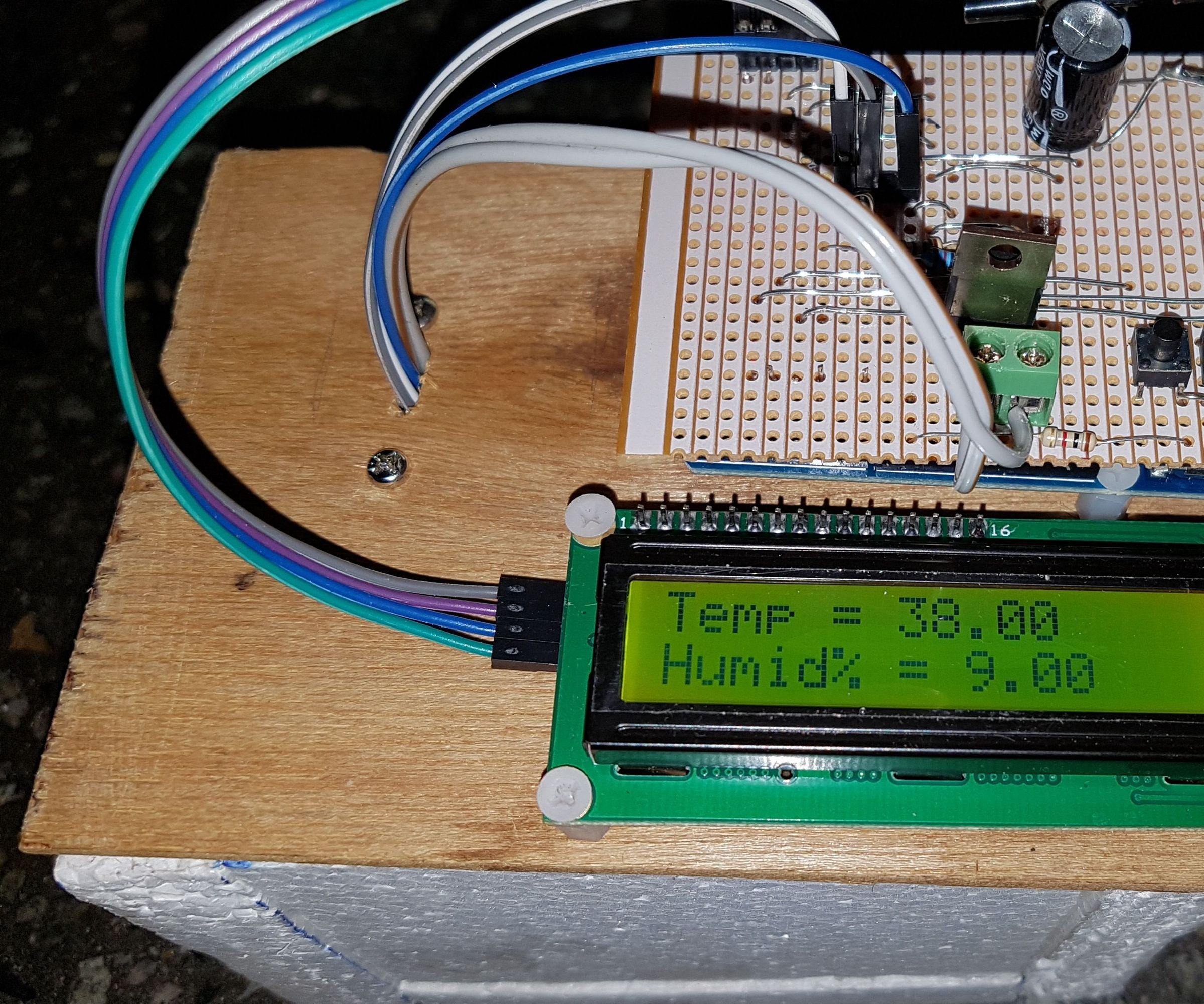

I am quite interested on working with Arduinos to control this. I have in mind using a mosfet (3055vl are good for switching little motors) to control both the light and the aerator (I'd use one from an old bait aerator, or one of these
http://www.ebay.com/itm/DC-3V-6V-370-Air-Pump-High... I'd like to use a DS18B20 to monitor temperature, and maybe a green laser module and a green-filtered bpw20 or other photodiode to do light scattering and turbidity so that real-time growth can be monitored. Maybe also I might look at making these chambers aseptic (eg put a 0.22uM filter on the air line and seal the inlets better).
