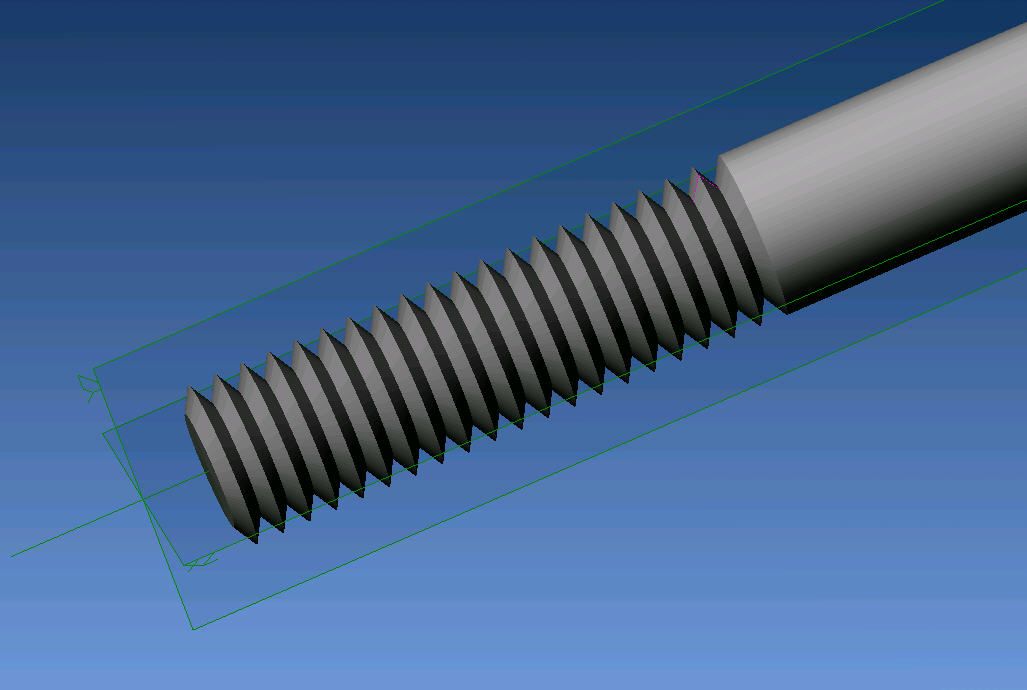

Step 1: Create a Cylinder
Create a cylinder matching you nominal diameter and length.
In this example, I used a 6mm x 50mm cylinder.
Step 2: Create a Cutting Tool.
Create a sketch that is perpendicular to the end of the cylinder. This means the the sketch we create will "hang off the end" of the cylinder.
1) Create an equilateral triangle.
Note the equal constraint used on each leg of the triangle, as well as the vertical constraint on the outside leg.
2) Dimension the distance from the center to outside leg as the radius.
Helpful Hint: by using the Equation Editor, you can set the dimension to diameter/2; then the cutting tool will follow the diameter of the cylinder if you make any changes
3) Dimension the size of the cutting tool to slightly less than the thread pitch.
This is very important, as this will keep the helix from overlapping when it is created and giving an error.
Step 3: Create the Helical Cut Feature
Click on the Helical Cut Tool and and enter in the Height and Pitch fields.
If I was thinking a bit clearer, the height parameter would be equal to the distance of thread I wanted, plus one more pitch length, but you can be sure to do that to yours... :)
Step 4: Making It Look Good... or Is That Well?
You should now have something similar to what is below. But, as you can see, the thread ends rather abruptly. If you wanted something quick and dirty, go no further, but if you need to make it look good, or well, or whatever, then read on...
