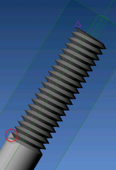

Step 3: Create the First Thread.
In a new sketch, draw a figure similar to this.
Notes:
The two lines creating the point and the reference line form an equilateral triangle.
The point is dimensioned to the radius of the cylinder
The edge of the sketch is constrained to the end of the cylinder.
Now, Rotate this Sketch about the Z-Axis.
Notes:
Step 4: Rinse, Repeat...
Now, we will make a pattern of the first thread.
Go to Feature -> Pattern -> Linear.
Click on the Revolution Feature to add it to the list.
Click on "Linear Path" in the "First Direction" portion of the dialog box, then click on the Z-Axis.
Spacing is equal to the pitch.
Copies is however many you need-- or want. ;)
Click OK

Step 5: Less Filling, Great Taste...
Now you're done.
This method works well for part that look like they are threaded, but don't really need to be. Consequently, since the helix is not used in this method the size of the file is greatly decreased:
Method 1: 835KB
Method 2: 484KB
