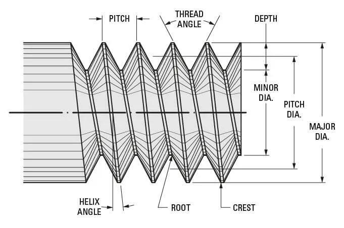

After reviewing the screw-thread-terminology post and photo, one can make some educated assumptions that may or may not work out. For once in time, I thought I could just post an extruded circle and then build upon it but how?
I did not know. I read articles and watched videos. I should have gotten a step guide of a book to walk me through CAD programming and building in CAD sources.
Actually, some of the articles were useful and got me far. I got to make threads on the Boss Extruded circle by means of a core set of principles.
  1. Threads and the inner working of fasteners are far more complicated that I can admit to currently.
  2. For one, shear strength and tensile strength play a major role in what type of material a bolt, so to say, would need to be made for a use case.
  3. Speaking of major...
  4. There is a minor and major diameter in specified bolts at different locations throughout specific fasteners.
  5. Interesting or complicated? Either way, the minor diameter is closest to the inner helix measured angle nearest to the centroid of the circle before it gets extruded by the Boss Extrusion tool within Alibre (from what I find).
  6. The major diameter is the furthest extent of the threaded area of the bolt, screw, and so on or crest to crest at 180 degrees.
Anyway, here is a photo instead of my jargon.

So, something like the Sketching tool would be used to handle the equal constraints of 60 degrees on the left and right side of our trapezoid (USA). So, if you have an eight mm bolt in diameter and want to have a correct thread pitch, and again beginner stuff for me while being a novice, on the lower extent of the trapezoid, type your pitch and divide by four.
Example:
Pitch = 1.25
Bolt Diameter = 8mm
For minor diameter of the thread, we use a simple formula: (Pitch / 4) = 0.3125mm
We can enter in the sketching tool once we boss extrude the circle on any plane fathomable. Oh! Use the chamfer tool to make a small chamfer on the end of the boss extruded circle that is now a cylinder.
This will make it easy to create a similar trapezoid/quadrilateral with specified parts by way of the line tool when building it.
