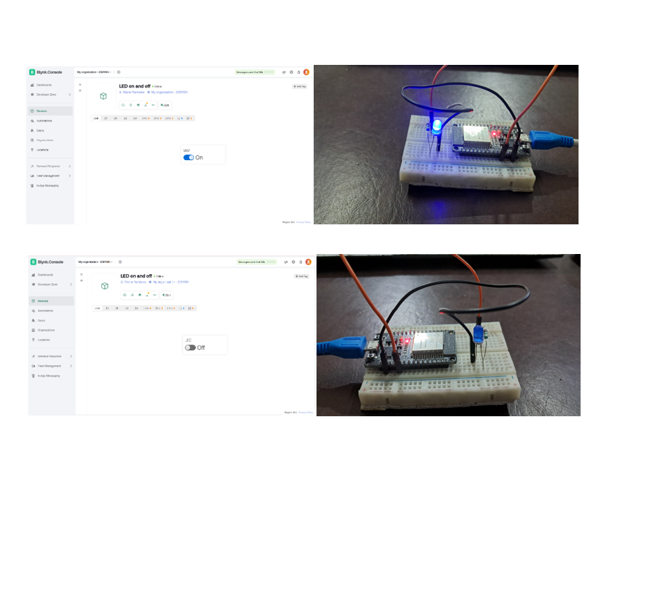

Step 1: Work With ESP32
I started ESP32 with simple code which I have given below:
Components:
  1. ESP32 Microcontroller
  2. LED
  3. Jumper wires
  4. Resister (220 ohm)
  5. Breadboard
  6. USB Cable
Connections:
  1. LED (+) = D2
  2. LED (-) = GND
  3. LED (+) to 220ohm to GND
Why I used 220 ohm resistor:
  1. The 220 ohm resistor is used to limit the current flowing through the LED. Without it, the LED could draw too much current, possibly burning out the LED or damaging the ESP32 GPIO pins.
What if we use a different resistor:
  1. 100 ohm resistor > Bright LED (More current, but still safe)
  2. 330 ohm resistor > Dimmer LED (Less current, Longer LED life)
  3. 1 k ohm resistor > Very dim (but still works)
Step 2: ESP32 Test & Blink Code
This is the simple code for ESP32 Test and LED Blink. Before handling any project of ESP32 microcontroller the basic things we should know for better performance.
I used ARDUINO IDE where I face ESP32 Board installation issue and the other problem was Port Not Detecting. So I am going to share you my simple keynotes of step by step guide of ho to overcome these common issues. See, whenever you use Arduino IDE it will ask you for Board and port. Finding Board might be easy but the problem of 'Port is not detecting' is very hard to face. With 2 days of self learning I got to know how to solve this issue.

Step 3: Explanation
const int ledPin = 4; // Change if needed
  1. Define GPIO 4 as the LED connected to the pin
void setup() {
Serial.begin(115200); // Start Serial communication
pinMode(ledPin, OUTPUT);
Serial.begin(115200); - Starts Serial communication at 115200 baud rate for debugging
pinMode(ledPin, OUTPUT); - set the GPIO 4 as the LED connected to the pin
void loop() {
Serial.println("ESP32 is working!");
digitalWrite(ledPin, HIGH); // LED ON
delay(5000);
digitalWrite(ledPin, LOW); // LED OFF
delay(5000);
Serial.println("ESP32 is working!"); - Print this message to the Serial Monitor
digitalWrite(ledPin, HIGH); - Turn ON the LED
delay(5000); - Wait 5 seconds
digitalWrite(ledPin, LOW); - Turn OFF the LED
delay(5000); - Wait for 5 Seconds
